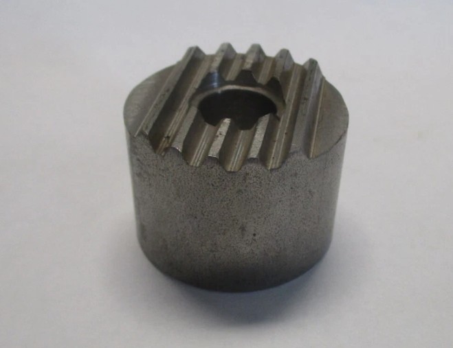

A couple of things on those Twin-Wheel drive mowers:  #1. Keep the sickle head bolt TIGHT. This bolt must be a grade 8 quality. #2. Make sure the serrations in the bushing this bolt clamps thru are CLEAN when assembling. #3. Keep the cross-arm snug against the bushing. Any looseness in any of these parts leads to quick destruction of said parts.

[QUOTE=DrAllis]A couple of things on those Twin-Wheel drive mowers:  #1. Keep the sickle head bolt TIGHT. This bolt must be a grade 8 quality. #2. Make sure the serrations in the bushing this bolt clamps thru are CLEAN when assembling. #3. Keep the cross-arm snug against the bushing. Any looseness in any of these parts leads to quick destruction of said parts.[/QUOTE
To add to this, a drop of red loctite on the threads doesn't hurt. Only way I could get mine to stay tight.

I was mowing with dads 82s. Had to remove the sickle to replace some sections and had a few questions regarding reattaching.
Only the head end has serrations? The bushing appears smooth on both ends.
The threads in the head end are partially stripped. Is a helicoil strong enough for repair?
How tight is tight for the cross bar ? I am afraid of cracking the casting. This one runs quiet.

Very early crossbar bushings were plain faced. Later ones had a serated face.
When I rehabbed my 82S, I used some parts from different mowers including a #7 and even that had the serated knifehead and bushing.
I have never even seen a smooth faced bushing but I know there must be some out there yet.
I don't think I would ever mix the two styles.
I would be looking for the matching bushing but I understand the serated bushings are scarcer than hen's teeth anymore.
That might account for a prior owner settling for the wrong bushing.
The threads on my knifehead were almost "shot" so I welded a quality nut on the bottom of the knife head. I only had to grind off a very little of it to make it easily clear everything on the under side  of the cut bar.
It has worked perfectly for years.
You definitely want this bolt to be tight and a Grade 8 bolt is definitely in order here.

The serrated sickle head and bushing are by far a better and more durable design, but again, that bolt must be kept TIGHT. Also, a dull sickle just adds to the stress of that whole area.

For what it is worth, looks like Allis changed to the channel type head and bushing midway in the production of the new style twin wheel.
The parts book lists both part number pairs (head and bushing) for plain and channel type. An inattentive reader could easily order the wrong match part. Guess that is what happened to Dad's.
Looks like serrated bushing can be bought.

For what it's worth - I have drilled and rethreaded the knife head and bushing to 9/16" after stripping threads on original.

Make sure to keep the head greased well as the serrated bushing rotates back in forth with the action of the sickle. Great mowers, visibility of the sickle while mowing is wonderful. No turning around to see what’s going on. Best mower AC made IMO.
