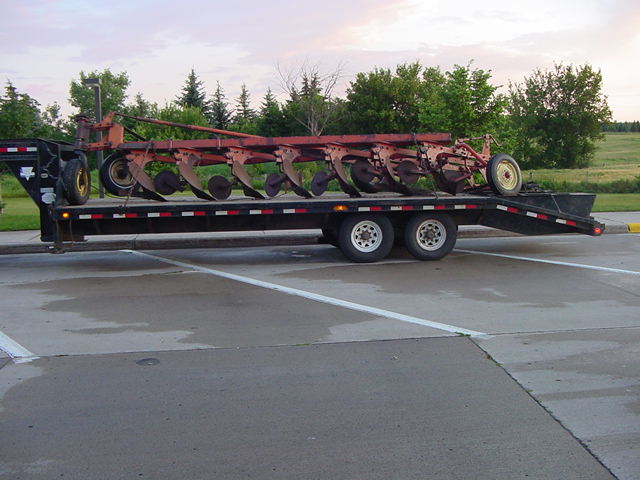

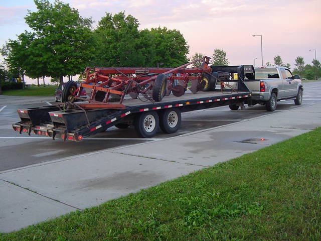

Would this be the 9000?  #9765?? I think they said the hitch is set for D21 on land...Dale

Orrangereborn, I'm sure that you have a 9000 series plow on the trailer.
I have a 3000 series 7 furrow semi mount 3pt on land hitch plow with auto resets.
I have never plowed with it. 3000 series are all 16" with 3pt semi mount on land hitch.
2500 series are 18" trailer plows only.
