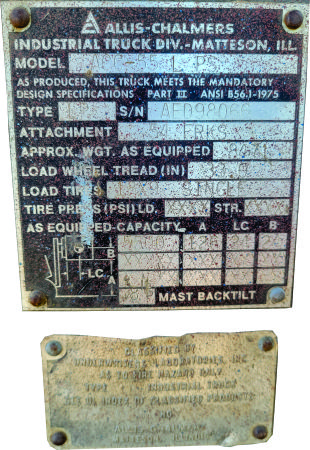

Hello All...  I just joined the forum as I am the new owner of an OLD Allis Chalmers forklift, Model ACC-55 L PS.  I have been trying to locate Technical Manuals or Maintenance Manuals for this this unit, but I have been unsuccessful.  I also want to determine the year it was created, but there is no date on the data plate (see image below).
I have been scanning the liberatedmanuals.com website for the military technical manuals but I doubt I will find one.  My forklift uses LP Gas and after 24 years of military service in logistics, I can honestly say that I have seen a military forklift that runs on Propane.  The closest manual I can find is TM 10-3930-630-24P which is for an Allis Chalmers ACC-40.  I would appreciate anyone's insights or thoughts about this forklift.  Thank you for your help...!
