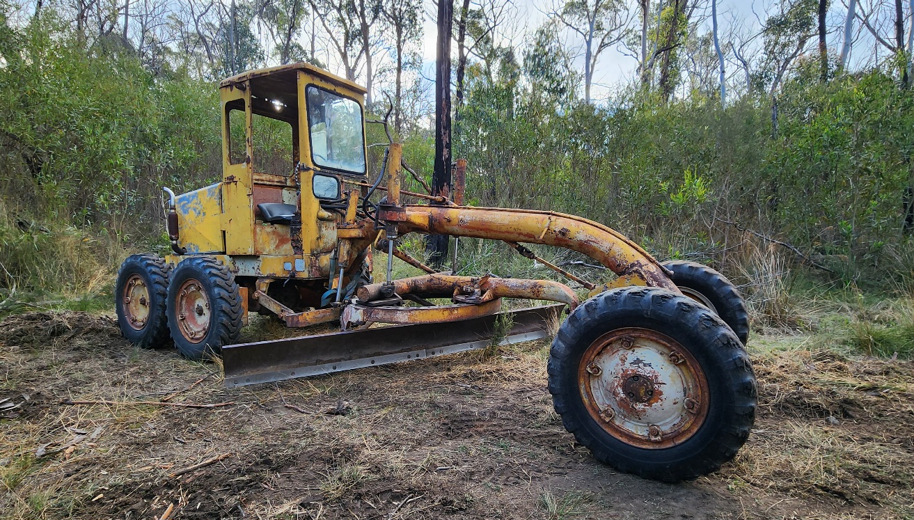

Hi, I recently purchased a 1960’s era D grader (in NSW, Australia). It originally had the Allis petrol engine in it, but has had a little Cummins four cylinder diesel fitted later. I am loving running it.
It’s a pretty tired old machine, so my expectations are low, but there are a few things that I would like to fix up if I can. I’d appreciate any advice anyone can give.

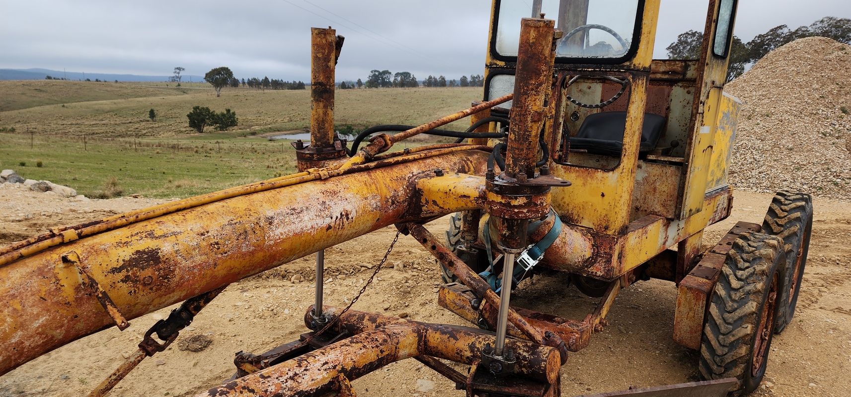

Biggest issue: the hydraulic ram that lifts the left side of the blade wont hold. Raise it up and it just wants to slowly drop again. The ram is leaking oil a little, so I figure the first step is to fix the seal and see if that helps. Can anyone point me toward a resource on how to rebuild these rams? Is it something I can do myself, or should I just pull them off and send them to some one to do for me?
Did any of these graders have an hydraulic steering booster? The steering is a real bear (of course) - not helped by the front wheels being “floppy” left and right as I have a feeling the wheel tilt mechanism was removed once upon a time (the piping for its hydraulics is still there on the nose).
Anyway, thank you in advance for any assistance. It’s greatly appreciated.

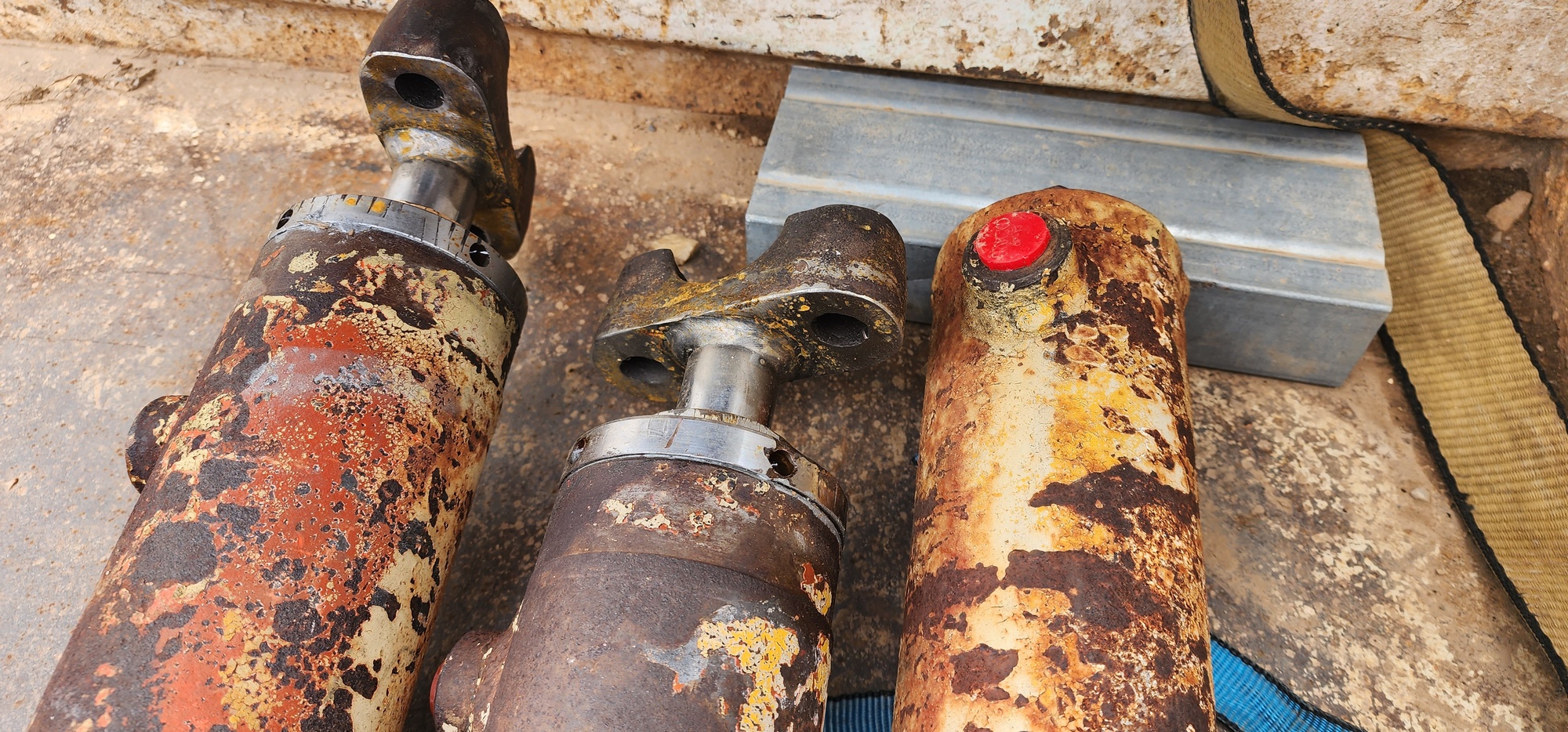

Update: I have pulled all three of the rams off the grader and due to time limitations I have sent them off to a local engineering company to refurbish.
When I pulled the ram off the ripper frame I found that the rod has some pretty bad scoring on it (no idea how that could even happen, but there you go!).  So I'm thinking that I might just replace it entirely if the cost of refurbishment is too high.

I picked up my remanufactured hydraulic rams this week!
They have been fully rebuilt - new rods, pistons, glands, and seals. It cost $700 per ram, but given the amount of work involved and the expected life span of the rams now (not to mention the ease of servicing in the future) I think that was a more than fair price.

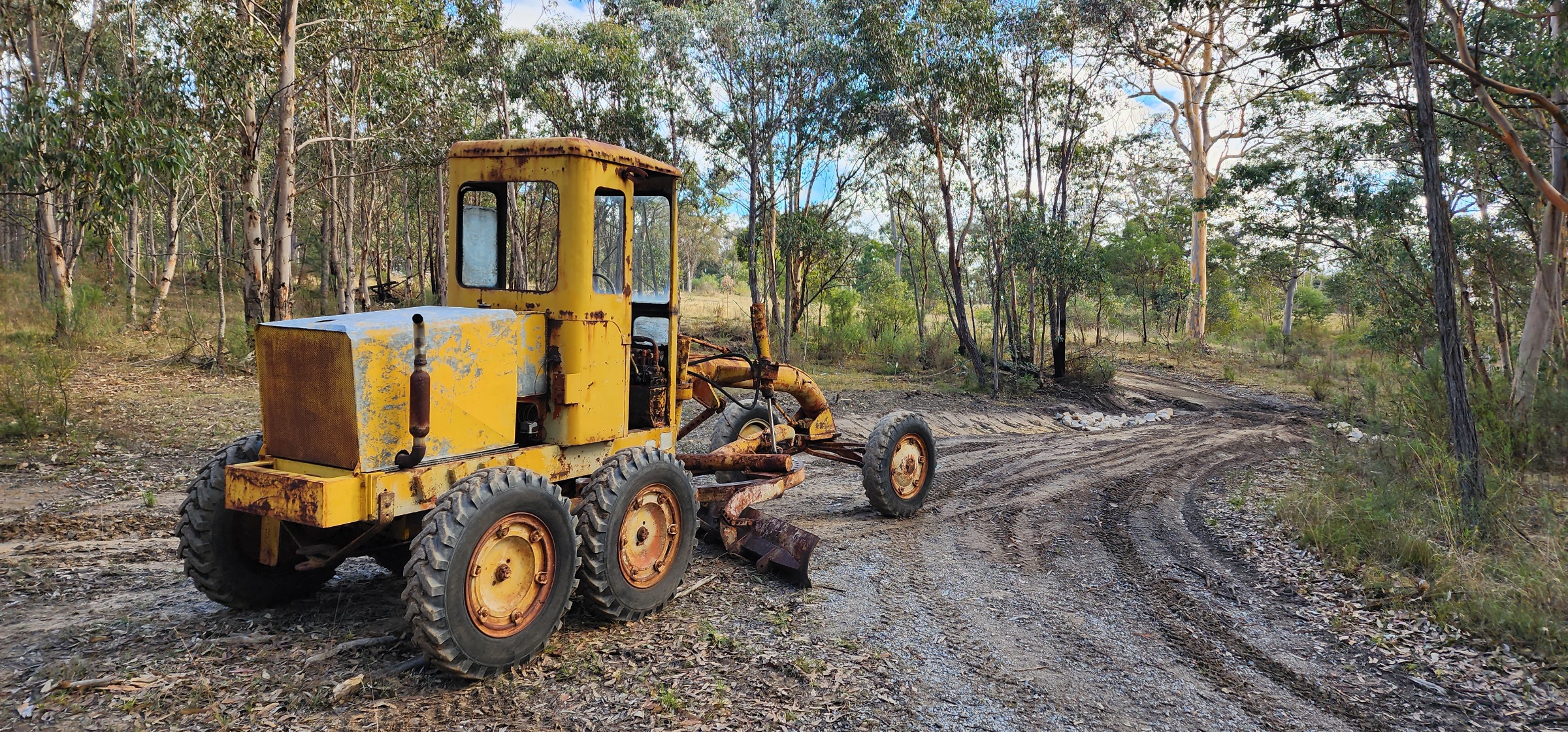

So I got all of the rams back on the grader and hooked up.
I've been running the machine for a few days and it's been working well. Only issue is I haven't managed to get the hydraulics bled properly yet. There are bolts on top of each ram for bleeding the top side of the rams, but can anyone tell me the best way to bleed the bottoms?
