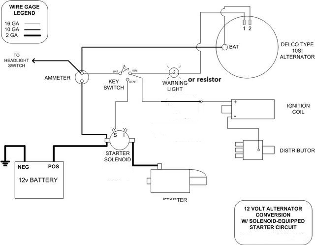

something like this.... Decide if you want an alternator. ( better idea)..... or use the old generator..

there needs to be a slight voltage drop between the two small spade terminals 1 and 2 on most alternators.. to make them charge........ The drawing shows an "idiot light"... this can also be a RESISTOR.. or even a DIODE........
As Les said, dont put a diode in the BIG LINE ( main charge line to battery )
