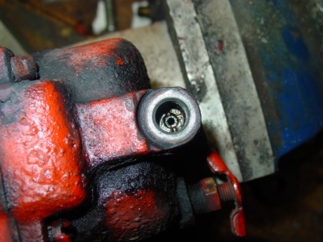

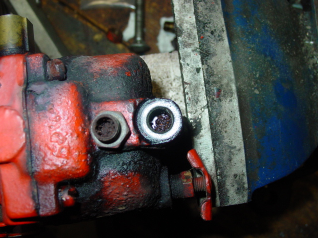

If the carburetor is leaking it has (DIRT) in it. It is either from the rebuilder or from the gas tank when the gas was hooked back up. Unless the carburetor has been switched it is a (non adjustable) jet carburetor.  Dirt getting into the bowel will settle thru the little hole just before the power jet.  This is the no adjustable carburetor you should have.
Power jet location
If the idle stop screw is set to fast the above could cause it to not have enough fuel thru the idle circuit.
It the rebuilder used a gasket that fit except for a different carburetor and the air hole was not in the gasket.
Until you have clean gas going into the carburetor from the tank and the carburetor clean your going to have problems.
