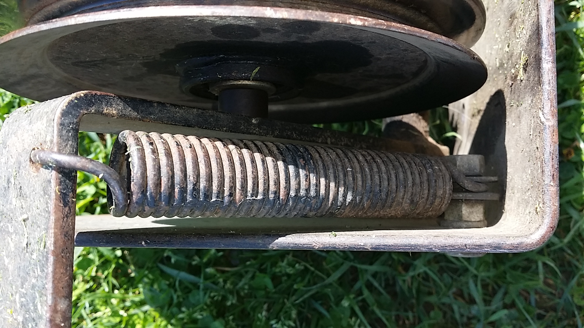

Don't know the number but I can get a picture of mine

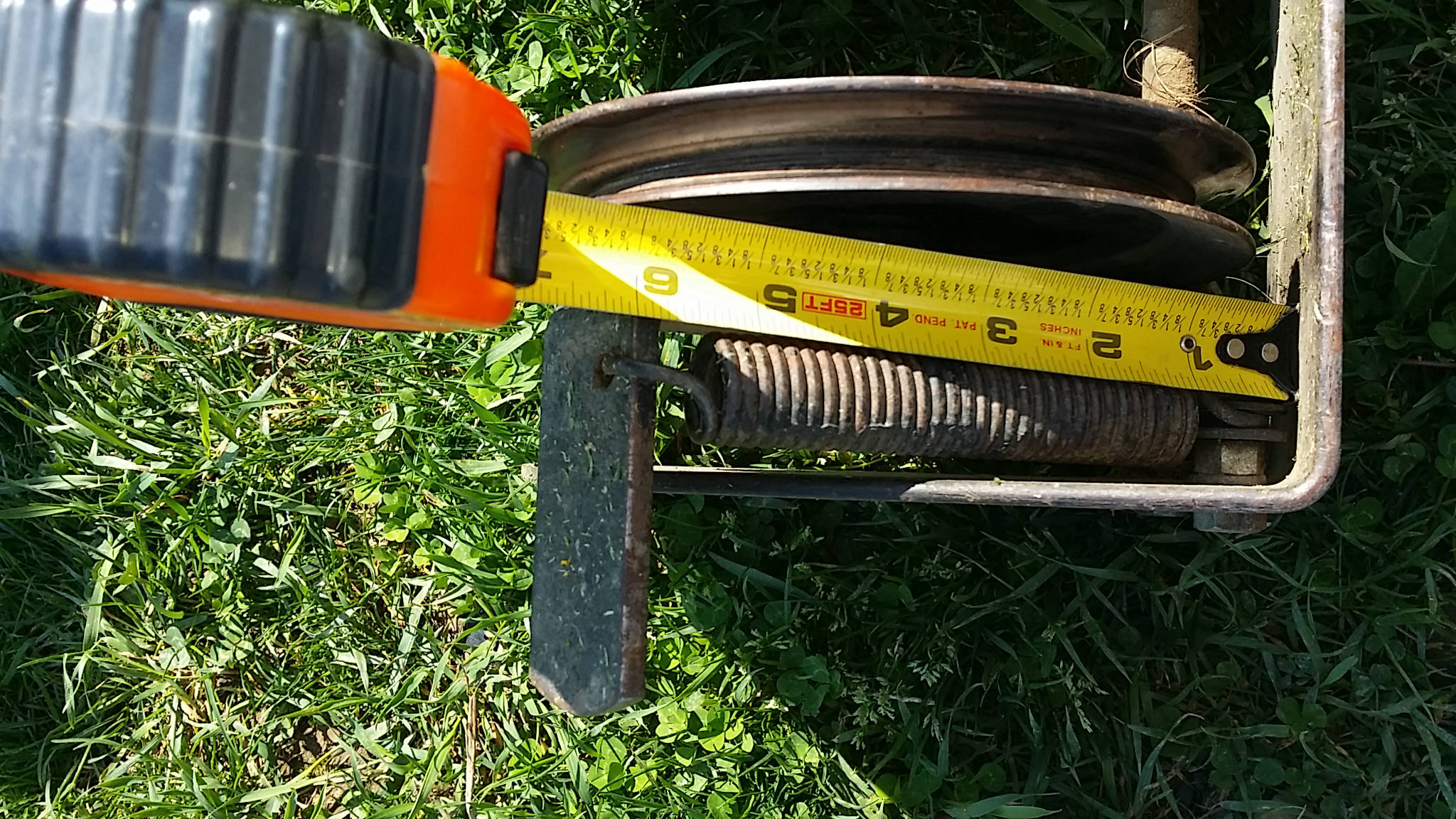

Thanks, and if you have an idea of the length, that'd be great!

Post Options Post Options   Thanks (0) Thanks(0)   Quote EricPA Quote  Post ReplyReply Direct Link To This Post Posted: 09 May 2016 at 9:20am

Thanks for taking the time to show me. It worked out! I had a spare spring that fit perfectly! Thanks for your help!

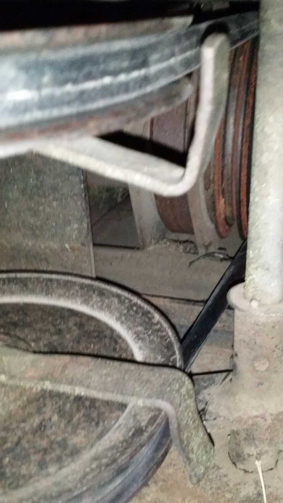

Does someone have a picture of the position of the belt guards on the pulleys below the electric Pto, I don't think one of mine is positioned properly.

Not sure what you mean. The only belt guards on the machine are fastened to the mower deck

The pulleys that you pictured above, do they not have a bar on then that secures over the belt? I'll try to get a pick.

There are 2 1/4" rods that hold the assembly on the tractor but not necessarily the belts

These two L-shaped bars that cover the belt on the pulleys

Ok,mine does not have those and I have never had a problem with the belt coming off. Don't recall seeing them in the manual either

I'll need to check. Thanks for the extra set of eyes.
