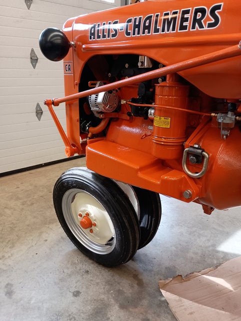

I just cleaned up the longer,  lower steering arm, the side weights, and the knobs they set on. Shot some high build primer on them maybe I can put some of that shiny PO#1 on them soon. The crude paint booth has helped reduce the over spray in the shop a lot!

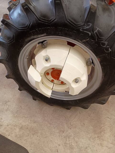

Also dropped off the IH rear wheel weights to get them cut in half. They have several saws that should make short work of those. I am going to make some brackets and sq tubing to allow our 15 lb weights to be added if needed.

I did get the parts painted to put the steering back together.

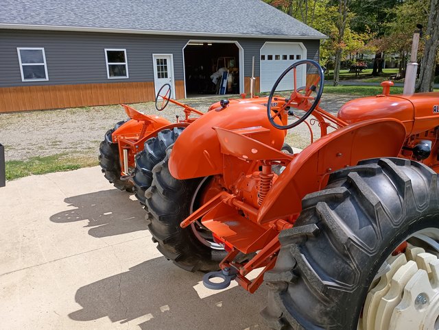

Just like you guys said it steers much better with this long arm installed. Should make a comfortable tractor to handle. The tractor would have worked with the short arm, but it is much better with the change to the long one. A nice ride in the dark down the road was positive. Oh yes the lights work great too. May not win many pulls but will present itself well.

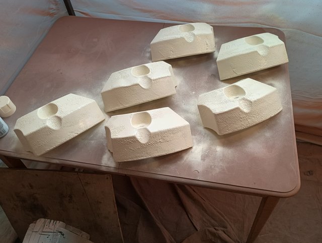

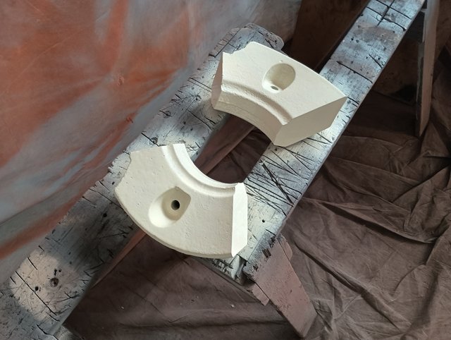

I picked up the rear wheel weights, which were cut into pieces that now weigh about 35 lb each. I am lightly sandblasting these weights, applying Rustoleum primer and then Rustoleum cream color top coat.

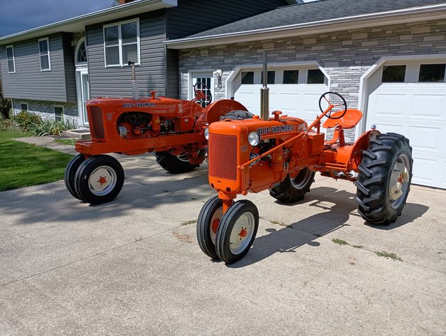

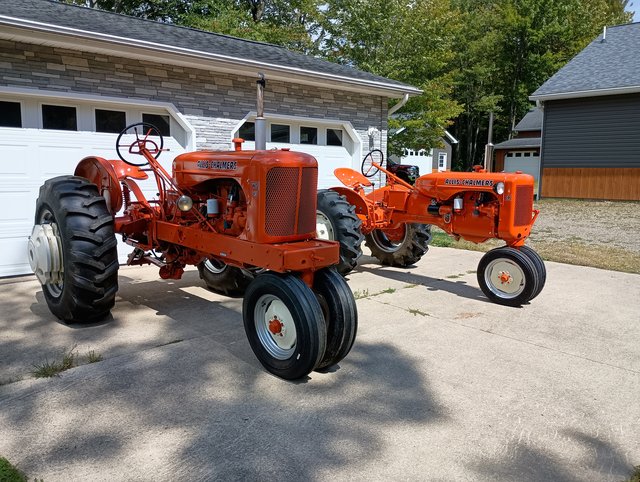

The plan is to take the CA, our WD45, and Grandson Nic's WD to the local Albion Fair starting next week. The show at the fair may lead into the tractor pulls later in the week too.
I took some time today to clean up the WD45.

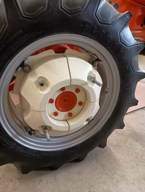

The 12 IH rear wheel weights are approx 32 ish each, bolting to the IH rims.

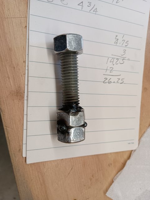

I fabed these 4 stud extenders to add the additional 4 weights to the rims after the eight were in place. Just tacked at this point.-+

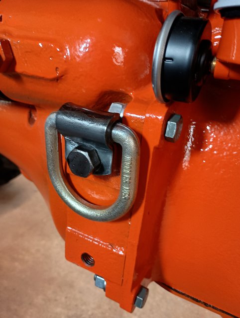

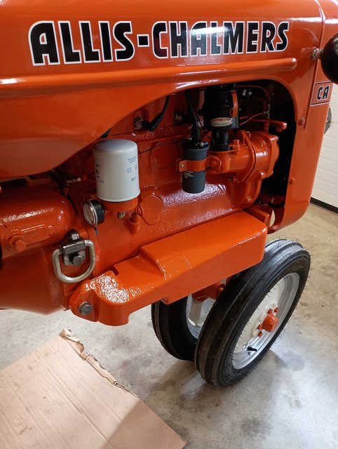

I wanted a D ring on each side to attach the tractor to the trailer. These were from Tractor Supply and were to be bolted the a trailer. I blacksmithed the attachment bracket to fit the tractor.

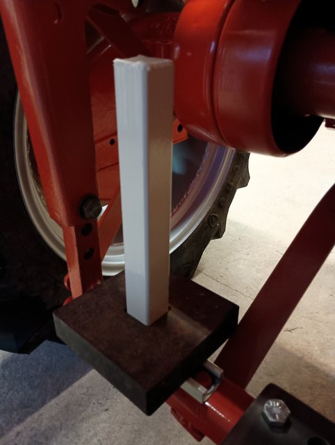

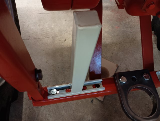

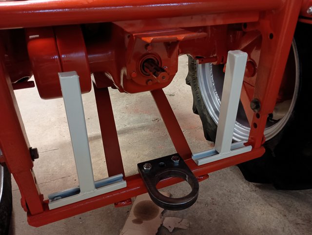

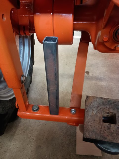

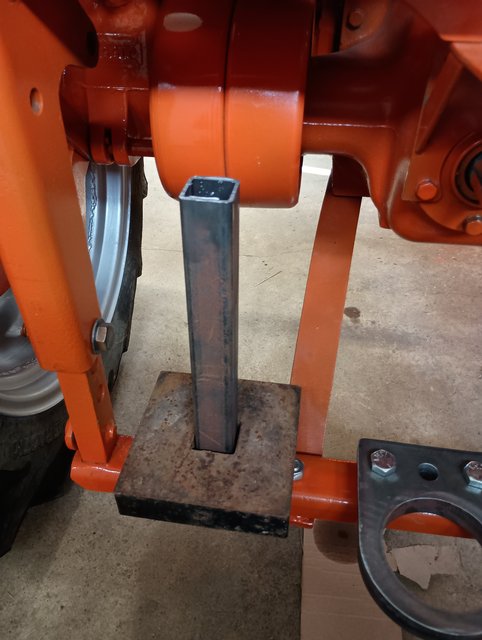

This is 1.5 sq tubing where I was mocking up a tube to hold the 200+ lbs of sq , 15 lb weights we have.
These flat sq weights can be stacked on these tubes. That should work.
All that playing around will get us in the 3000 lb class if desired. Or allow us to add some weight if the Great grandkids are driving the CA.

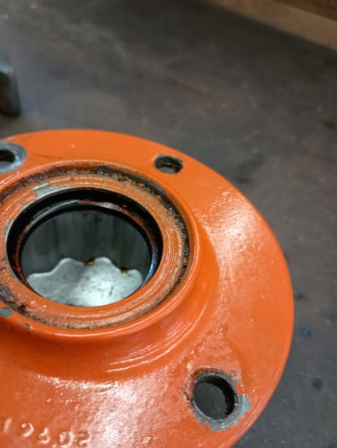

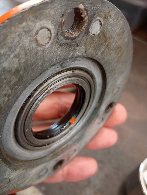

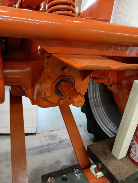

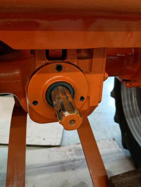

New seal in place for the PTO:
 old seal tapped out with a large socket

Weights added. The extensions worked well to secure the outer weights.
Engine -2 side weights. These are awkward to install.
