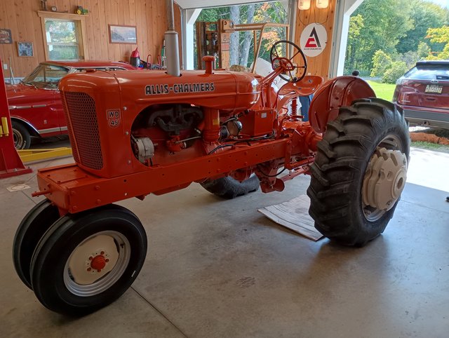

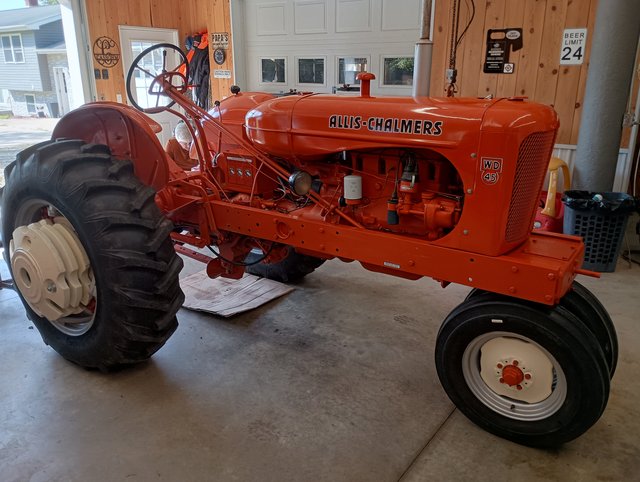

I took some time today to clean up the WD45.
 Chris and Cheryl
