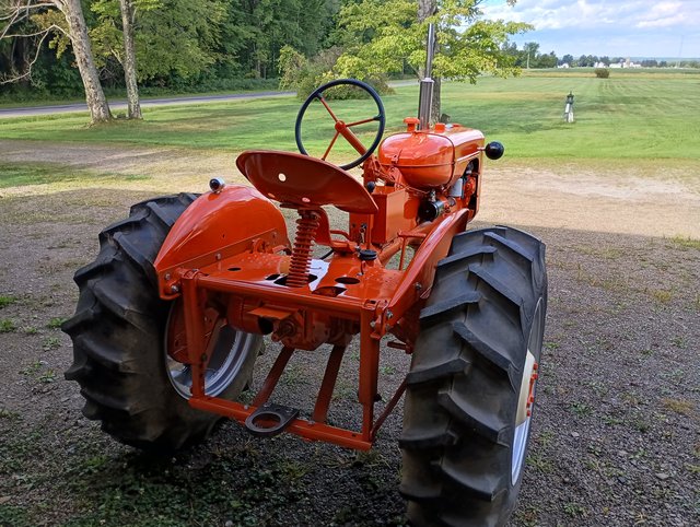

 A little more of that too! I did leave the dash box in the lower position. I couldn't get the 5/16 nut on the back of the box. The Battery box bracket was in the way.
Remember this is only a Clean, Refurb, and Paint project. I have had the gas tank assembly on and off several times. I forgot I needed to run the wires in the tool box area.
Headlights and tail light wiring is what's left to complete.

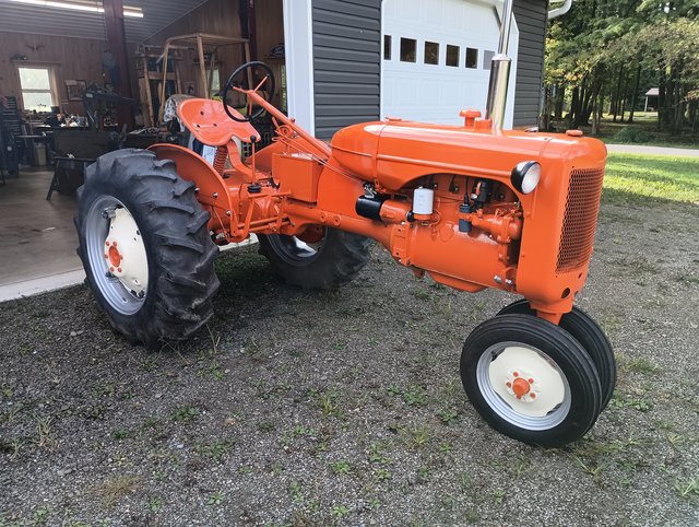

Tonight I completed the spark plug wires. Primed the oil pump. Got a new battery from Walmart. The old battery had been used on my electrolysis tank and it is pretty hard on them. It would spin the tractor and then die. Took a couple tests to determine it was not good under load. Oil pressure is at the N in normal with our running yet. Just cranking.
I tried the hood. Looks like it will be ok when finally fit.
Busy day tomorrow but may try to start the CA? Cheryl's birthday is Tuesday. I would like to have it running. I did try the lights and they worked.

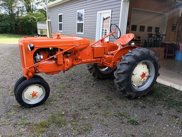

Some other shots:
I know the cable colors are not correct. But that is what NAPA had.
Luan cover to keep lid off the terminals
The silver bullet
Cheryl helping prime the oil pump. Crude set up but it worked!
 Chris and Cheryl

I added some gas and friend John came over this morning turned on the gas, flipped the key and pulled the starter rod. It fired up. We weren't there. Got out to the shop in a half hour and started it several times today. Even took it out around the shop. All gears seemed to work. Brakes worked very well! Steering not great, stiff. Should work fine for pulling. Oil pressure was very good.
Had a minor problem with the side hood bolts being too long. My fault. fan blades hit them and luckily did not do much damage. Got that fixed (Dodged a bullet on that fan thing, could have been way worse!). It seems to run pretty well.
Have some oil coming out of the short hose from the air cleaner to the carb? Not sure what the cause is? Also have a leak at the upper edge of the hose from the water pump to steel tube. Pictures are coming!
Tomorrow is Cheryl's birthday! Hoping to get the decals on tomorrow too.
Warmed it up at different rpm's, pulled valve cover and set valves to .012 inch.
I repainted the hood strap and the oil filler cap this afternoon and installed them this evening. The paint was too light, ok its not going to be perfect. Went around and touched up a bunch of areas that have been light and or missed or scuffed.
