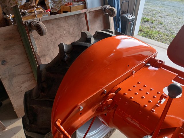

So today we sanded the primer with 220 to level the surface a little more, and remove a few runs. I was able to prime all the parts again. The hood needs a little more attention, so I may be able to get it in primer tomorrow.
Here is the left fender just out of the crude paint booth. I think the parts are going to be ready for Persian Orange number 1 soon. Getting tired of sanding. But I have continued to try to improve my skills in body work over the years.
I plan to scuff the parts with scotchbrite, tack them off and prep for finished paint.

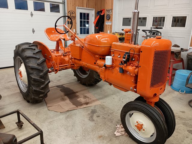

Guys,

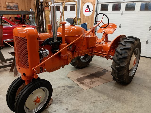

 Like when I was a kid putting models together. Just cant stop if the parts are ready to assemble.
Almost back to normal!

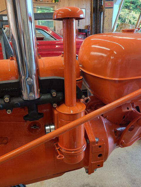

Guys a few more details of the old CA project.
This has been 3 years. I haven't worked very fast on this tractor!
Some of the first parts I painted did not get enough paint. Like the side rails where the fenders bolt on. And yes I added my special orange peel affect in the paint too. I mean it is orange right? Gotta have the orange peel!!  And don't forget the custom over spray to provide extra texture and grip at certain areas of the sheet metal! I hope the decals hide some portion of that too! It just may have to be this way, and let the next guy worry about it 70 year from now:)
Really hoping this old CA becomes a family tractor for one of the great grand kids. Kolten is 13 and will be able to pull at the local fair this year. He has 3 more year before he can pull at some of the other local events. Am hoping one of the 6 develops an interest in this old orange iron, I cant pull them all! :)

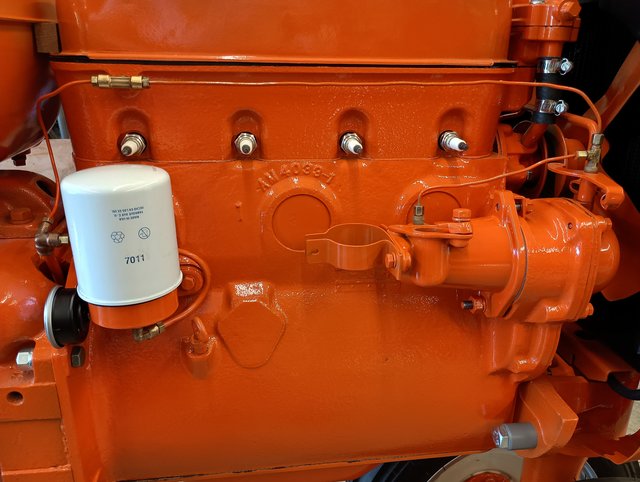

Guys,

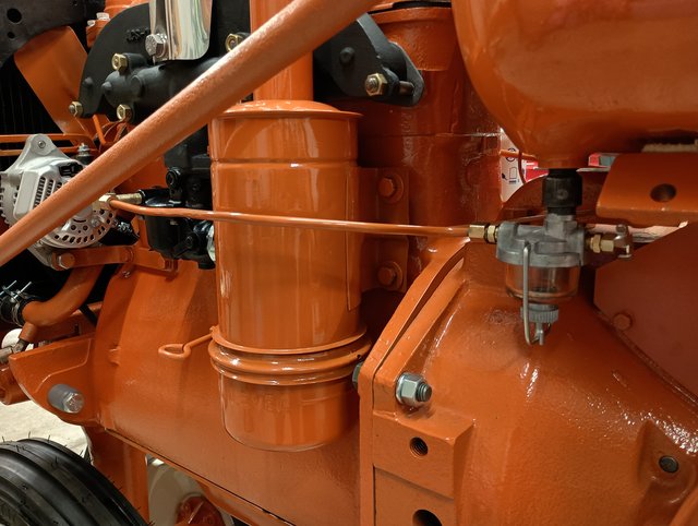

After the afternoon nap I cleaned up all the oil lines on the CA. Blew them out and found where they all went. I added oil to the air cleaner cup to the correct level. Installed the oil pressure gauge. Added 4 quarts of Napa oil to the engine. Cheryl and Ruby were out there in the shop with me, the temp was just starting to cool down. Awesome night with dark storm cloud cover and a bright pink band of sky at the horizon over Lake Erie to the west.
I was also setting the toe in on the 65 Comet front end. It's good to try to still multitask:)

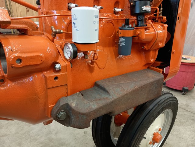

On the CA I realized I needed the extension on the sediment bowl.
Oil lines in place

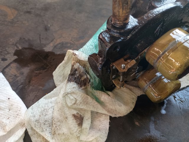

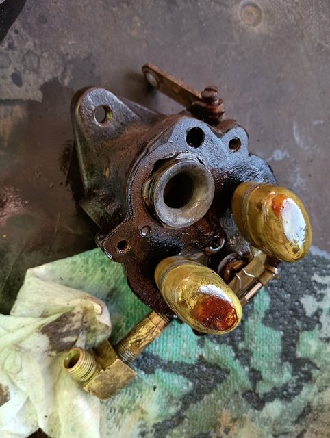

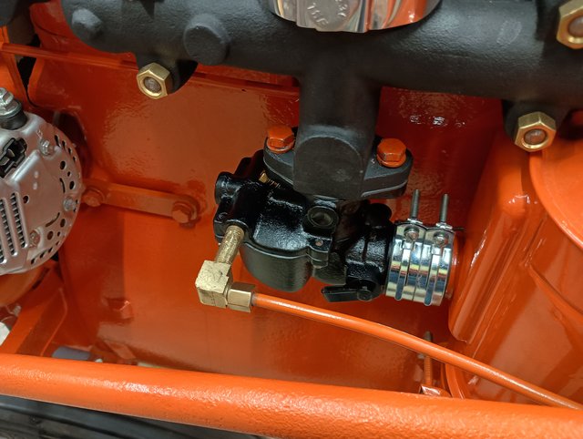

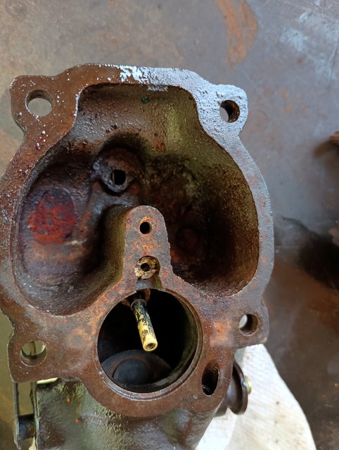

The Carb came up on the list of things to do. It was very dirty and crusty inside and out. Several of the brass jets had already been messed up. I did not have new ones in the kit. So these were cleaned with carb cleaner and opened for fuel or air flow. Emulsion tube was removed and cleaned on this Zenith carb.
After some cleaning and yes I blasted the top and bottom of the carb. They were that bad. I mask areas during blasting.  I had to rebuild the choke plate with the little spring loaded button. The button was froze up. I also put it together wrong. Couldn't figure out to get it back in for a couple tries.  Lots of little details. I need a better seal for the main fuel screw.

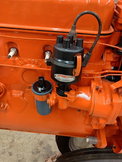

I know the carbs are not supposed to be black, and the fuel line is supposed to be behind the air cleaner.

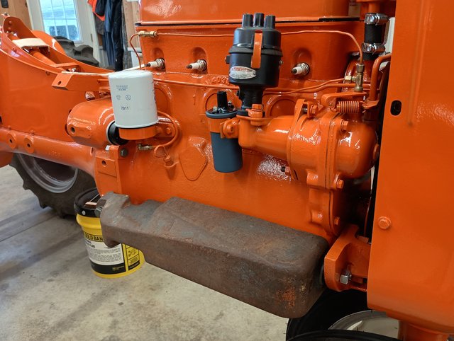

Yep a black distributor:
I need to make up the new spark plug wires. Then begin to set up the wiring for the rest of the tractor.
We did prototype the front engine side weights. All looks good. Kolten said these should be orange. The rear wheel weights need to be the cream color. Not sure how much weight will be needed?

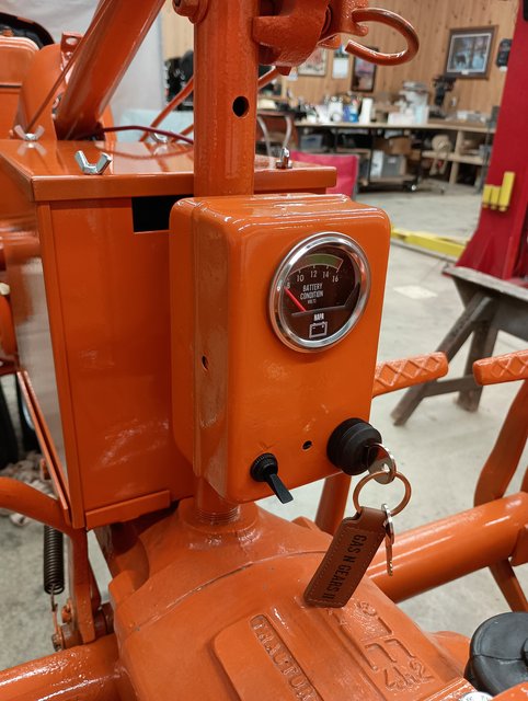

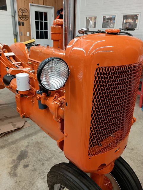

Prototyping the headlights
I have moved the dash box up a set of holes, I think its supposed to be at the higher position?
