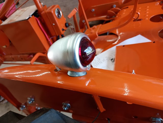

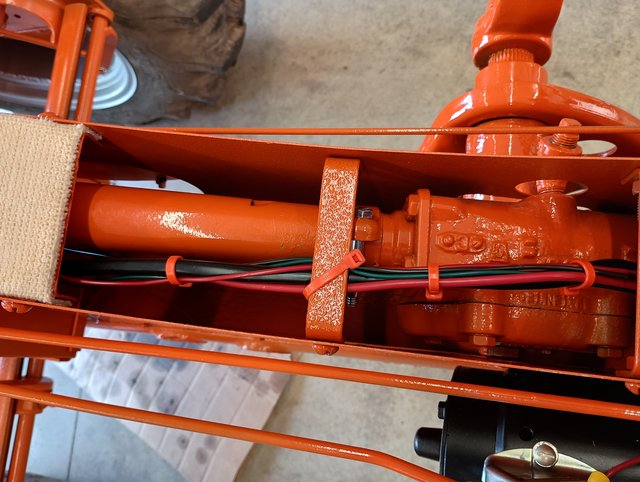

Headlights and tail light wiring is what's left to complete.

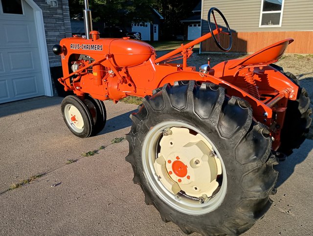

Guys,

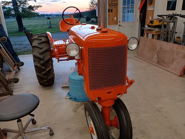

Almost there!

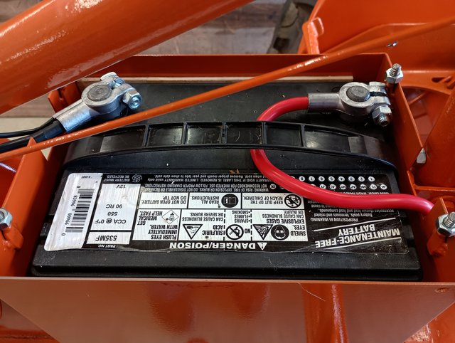

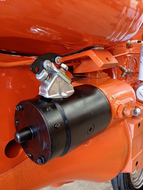

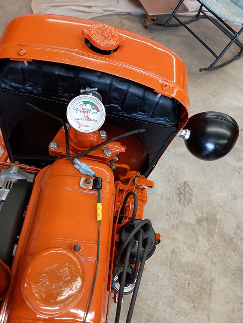

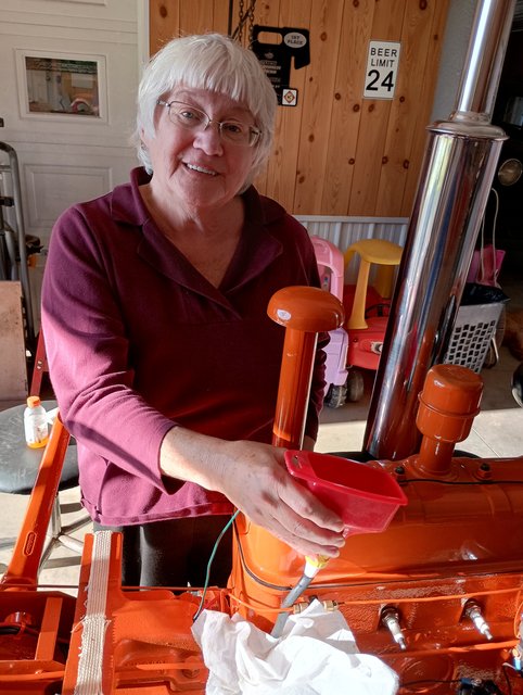

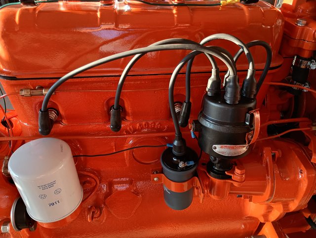

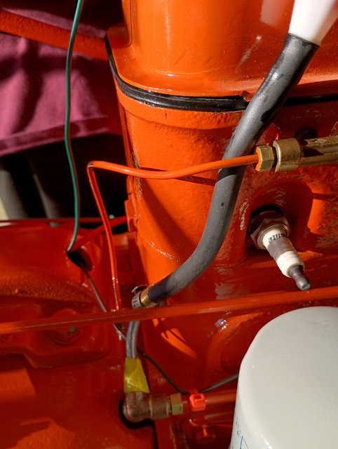

Tonight I completed the spark plug wires. Primed the oil pump. Got a new battery from Walmart. The old battery had been used on my electrolysis tank and it is pretty hard on them. It would spin the tractor and then die. Took a couple tests to determine it was not good under load. Oil pressure is at the N in normal with our running yet. Just cranking.
I tried the hood. Looks like it will be ok when finally fit.
Busy day tomorrow but may try to start the CA? Cheryl's birthday is Tuesday. I would like to have it running. I did try the lights and they worked.

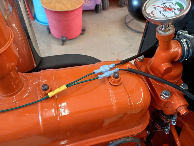

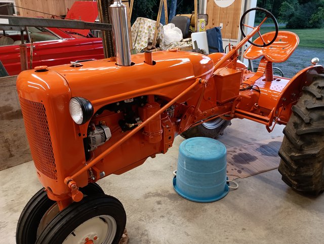

Some other shots:
I know the cable colors are not correct. But that is what NAPA had.

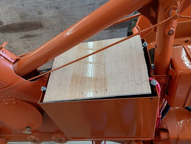

Luan cover to keep lid off the terminals
The silver bullet
Cheryl helping prime the oil pump. Crude set up but it worked!
 Chris and Cheryl

Guys,
 Thanks!
Sparky,
 I welded in a sheet metal patch where the hand clutch was. I thought someone might get a small foot in there.

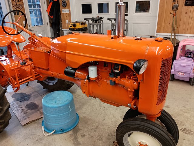

I added some gas and friend John came over this morning turned on the gas, flipped the key and pulled the starter rod. It fired up. We weren't there. Got out to the shop in a half hour and started it several times today. Even took it out around the shop. All gears seemed to work. Brakes worked very well! Steering not great, stiff. Should work fine for pulling. Oil pressure was very good.
Had a minor problem with the side hood bolts being too long. My fault. fan blades hit them and luckily did not do much damage. Got that fixed (Dodged a bullet on that fan thing, could have been way worse!). It seems to run pretty well.
Have some oil coming out of the short hose from the air cleaner to the carb? Not sure what the cause is? Also have a leak at the upper edge of the hose from the water pump to steel tube. Pictures are coming!
Tomorrow is Cheryl's birthday! Hoping to get the decals on tomorrow too.

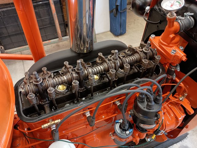

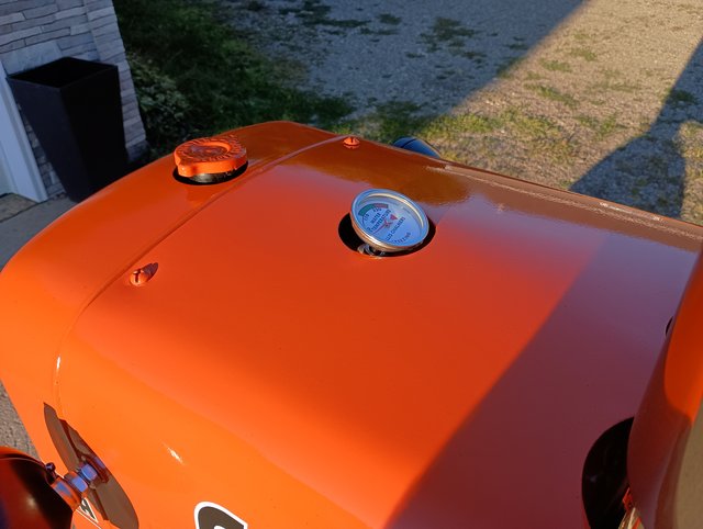

Warmed it up at different rpm's, pulled valve cover and set valves to .012 inch.
I repainted the hood strap and the oil filler cap this afternoon and installed them this evening. The paint was too light, ok its not going to be perfect. Went around and touched up a bunch of areas that have been light and or missed or scuffed.
 Chris and Cheryl

Check and see if you’ve got too much oil in the oil bath air cleaner.

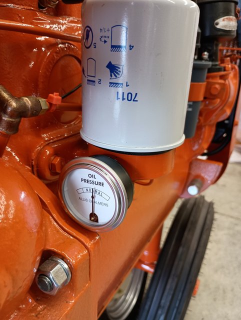

Your oil pressure looks great!!!
Dan

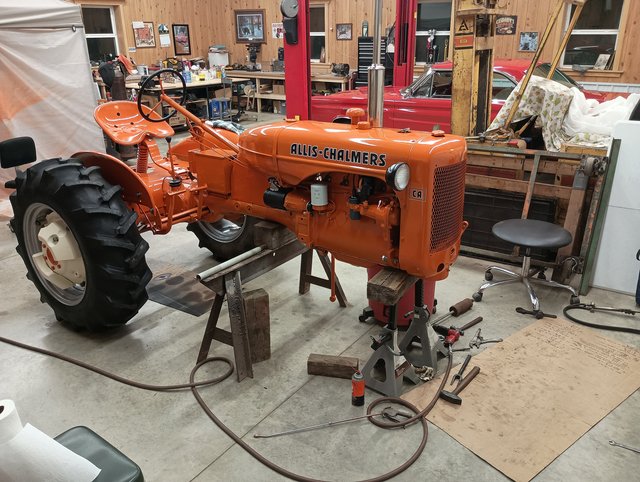

Points: 8570
Post Options Post Options   Thanks (0) Thanks(0)   Quote Sugarmaker Quote  Post ReplyReply Direct Link To This Post Posted: 27 Aug 2025 at 8:07pm
Guys,
I called Sandy lake and ordered a cork valve cover gasket. This OEM black rubber gasket thing doesn't seal at all!!! Oil running down both sides of the engine. I will have to take the hood off and on again! It really is a two person job on the hood install with the headlights on but loose. I also ordered a condenser for a mag. Said to be a better condenser??
Today I pulled the alternator and tried to goop up the leaking hose from the water pump, will see how that worked?
Pulled the carb again and re set the float to close the needle valve sooner.
Grandson and his boys came up and drove the CA a little. Seems to be running ok!
Decals went on this morning. I don't like this mylar type as well as the single letter vinyl.
I will try to take off the hood and put the new cork valve cover gasket on. Does anyone glue these down??
 Will also put the new condenser in the distributor. Have only been setting the timing by ear, turning the distributor till it sounds happy.
It steers very firmly! No wobble in high gear on the road. Will work fine as a puller!
Chris and Cheryl
Edited by Sugarmaker - 27 Aug 2025 at 8:09pm

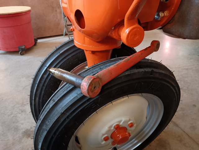

...It steers very firmly! No wobble in high gear on the road. Will work fine as a puller!...
I was curious as to how that long arm/short arm combination would work
Dirt Farmer View Drop Down

Thanks for the support on this CA project. I took it for a 1/2 mile ride. Yep steering is stiff but manageable. Short arm, long arm is not the best combo. Valve cover gasket seems to be finally sealed up.

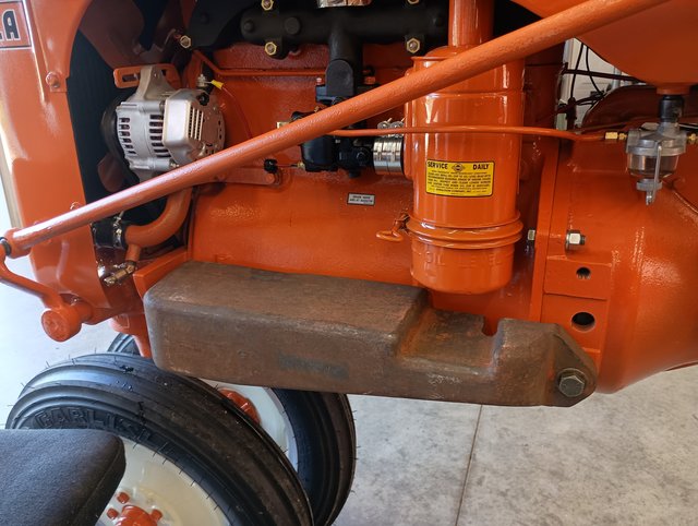

I got the wheel weights on the rear. Thinking of getting the other set of rear IH weights cut in half too? Would be much easier to handle for sure! I need to see if my machine shop has an easy way to cut these IH weights. Would need another 500 lb. The engine weights plus the 2 more IH rear weights and a bunch of my 15 lb weights would be needed.
Still have the engine weights to wire brush prime and paint PO#1.

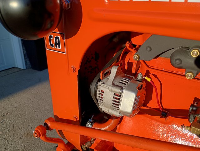

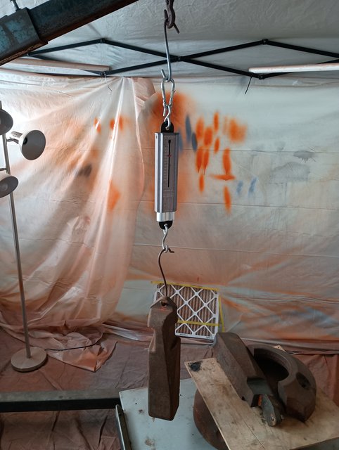

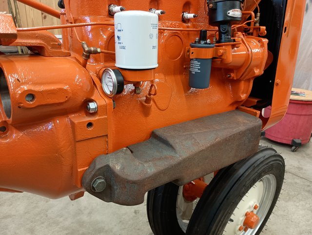

Points: 8570
Post Options Post Options   Thanks (0) Thanks(0)   Quote Sugarmaker Quote  Post ReplyReply Direct Link To This Post Posted: 30 Aug 2025 at 6:18am
Guys,

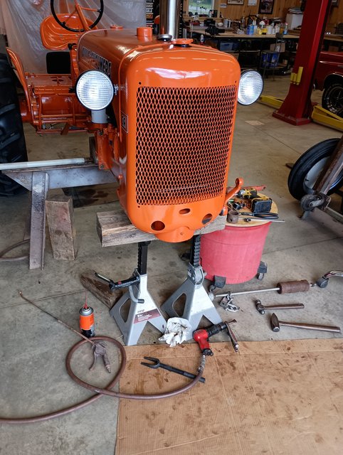

 Continued shake down of the CA.
I did take the alternator off again and took the leaky hose connection off the water pump outlet. Put some silicone goop on the surfaces. Reassembled and it still had a small leak. I put the sealant in and after running several times and coming up to near 170F. Most all of the dripping from that minor problem are gone. On to the next.
I found that the oil leak at the rear was from seepage at the PTO shaft. I removed the PTO cover/ guard. Cleaned the shaft where there was a slight grove at the seal location. The seal was very dirty but intack. I cleaned the seal up. Then removed some of the shims that space out the cover. The idea was to move the seal to a slightly new position on the shaft.
Well removing the shims tightened up the rotation of the shaft. But it also stopped the leak!
So I think I will zip tie the PTO lever in the off position. I dont think we will need it for pulling. But the CA would be a great tractor on our buzz rig someday if needed.
When I pulled the carb and reset the float, I thought that might help if I left the fuel on? Well I did and that did not stop it from flooding out the carb!
I did weight the engine weights and with the hard ware each would be 90 lb.
Took the CA down the road in 4th gear and it runs good. Some minor steering moves to keep it headed straight. I think the incorrect steering arm makes it turn very quick, checked this at low speed only!:)
Hope things are good in orange land!
 Chris and Cheryl
Les Kerf View Drop Down
Joined: 08 May 2020
Location: Idaho
Points: 1384
Post Options Post Options   Thanks (0) Thanks(0)   Quote Les Kerf Quote  Post ReplyReply Direct Link To This Post Posted: 30 Aug 2025 at 7:42am

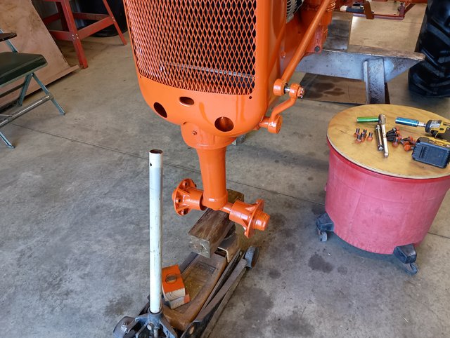

... Some minor steering moves to keep it headed straight. I think the incorrect steering arm makes it turn very quick, checked this at low speed only!:)...
Yup.
The overall steering ratio will be about half of the original, so each degree of steering wheel movement will produce about twice as much change in direction.
Points: 8570
Post Options Post Options   Thanks (0) Thanks(0)   Quote Sugarmaker Quote  Post ReplyReply Direct Link To This Post Posted: 30 Aug 2025 at 8:16pm
Les,
Yes that sounds about right on the quick steering. The reason I wanted this front end retained was for the side engine weight attachment. We got that and then quick stiff steering as a side benefit. It will probably be just fine for what we are doing with this old CA.
Weights:

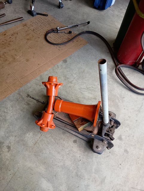

Had you changed the steering casting to the correct CA casting, you could easily attached the B/C side weights the the CA front steering casting by just using s longer bolt.
  What you can't do is put the CA side weights on a B or C tractor.
  The CA front casting would also give you more options for front weights. I have some small cast weights the perfectly match the cultivator front mount holes. If you remember, I have a CA steering casting I would have given you had you picked it up or met me at one of the pulls I go to, or I could have sent it along with a buddy that went to a truck show in NE Ohio.

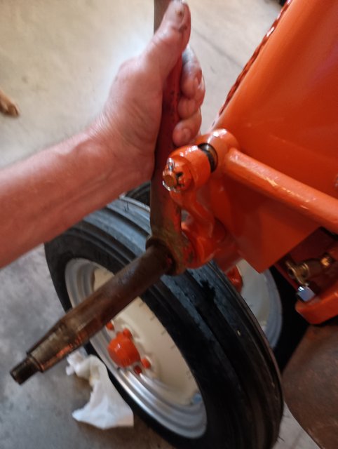

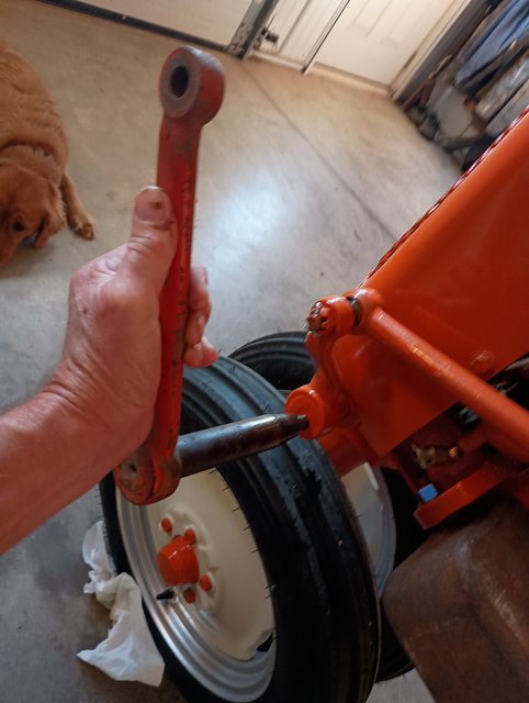

Points: 8570
Post Options Post Options   Thanks (0) Thanks(0)   Quote Sugarmaker Quote  Post ReplyReply Direct Link To This Post Posted: 31 Aug 2025 at 4:58pm
Paul, Folks,
 Thanks for checking on me. I had forgotten about the steering casting that you have. That's an idea for sure. I think I got long arm casting but it did not have the lugs on the sides for the weight bushings to be attached. Maybe that was from a long arm C?? I will have to look back on that.
BTW the reground cam seems to be running fine.
I got to thinking on this long arm/ short arm thing. And Ok I am old and somewhat brain dead. So the gerble jumped back on the little wheel in there, and I think I still have that long arm, no wheel weight lugs, upper casting. I never thought about taking the long arm and its shaft being removed from the casting. Humm. Someone had to put it together, That arm did not grow in there.

After a little nap I remembered the engine weights. Are these all the same or is there a right and left hand weight? I have two that have a -2 cast into them. It seems they both fit even though they are not opposite hand.
Doesn't seem like something that would be engineered like that??

Chris, Brian Ahart's site seems to indicate that the one without the bevel might be earlier? However your weight without the bevel has a -2 in it, it sounds like, instead of the -1 shown on Brian's site. That is probably a revision number but I don't understand why they would have made a -2 both with and w/o the bevel, if this is the case.
The preceding part number is AM3315 on both of yours?

wjohn, Folks,
Both of the -2 versions have the bevel as shown in Brian's picture. Might not be clear in my pictures? The weight has to be inverted to fit the opposite side of the tractor. So I guess as others have noted I have 2 of the B/C weights with the AM3315-2 Like the rest of the tractor mismatched stuff through this unit! The weights look like they will fit and work on both sides of the engine.
Thanks guys for the leads on extra weights available. A friend may be looking for some of these for his CA tractor.
So I started on the front steering prototyping of the CA steering arms. This may work? I almost have the shaft out of the gear in the casting that is on the tractor. This short arm is a different shaft and gear design than the long arm version. The short arm gear is keyed on a straight shaft. It has a typical Allis set screw with a lock nut like the one holding the starter in place as an example. So I have the shaft almost out of the gear. Yikes it is really happy there! Hope to get that apart tomorrow. Then I will attempt to install the long arm and its gear, key, and lock nut assembly. If it doesn't not work, well I will have learned a little more about these tractors.
 Chris and Cheryl
