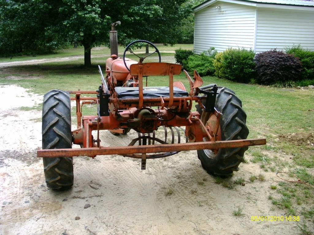

How about these?
Sorry, that last one was a B without cultivators.

OK, the left side sweeps are missing in these pics, as well as the three shanks with shovels that go on the back bar. Just some pics I took when I was getting her ready to work.
I didn't do it! It was a short, fat, tall, skinny guy that looked like me!
DREAM View Drop Down
Joined: 06 Jan 2010
Location: Elberton,GA
Points: 1828
Post Options Post Options   Thanks (0) Thanks(0)   Quote DREAM Quote  Post ReplyReply Direct Link To This Post Posted: 10 Nov 2011 at 11:11pm
The rear tool bar for the 80 series cultivators mounted to the rear set of holes in the finals. I'm not sure, but I think the 80 series mounted planters used the front holes for the lift pivot point to keep everything in line. Finals were cast in such a way that they could be used for either left or right side on any tractor. Lot less expense at the foundry that way. This was also taken into account when making implements. Very smart, weren't they?

Yeah, i've never seen another set of sweeps like those. My grandad and his first cousin farmed together. Both had Cs, and both had the same sweeps.
Makes it very easy to change out. They would drop the wsweeps off and use the rear bar with 3 shanks to lay off rows for veggies, then go back and put the sweeps on so that they would throw a little dirt into the furrow to cover the seeds. When it was time to cultivate, they swapped sides with the sweeps and they would pull the dirt/weeds away from the rows. Time for side dressing, swap sides again and throw dirt to the roots. Worked out well, and took no time to change.

The cultivators fit the wide front C the same way. Not as easy to install since you can't just drive between them. With a Wide front you drive in get the outboard ends of the cultivator on the cultivator front suppont bar then lift the back and swinge them in. thats wy NF tractors were more popular in areas that did row crop farming.
