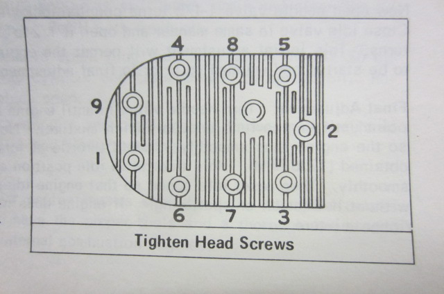

They are Garden Tractors. As you can get a full line of garden tools to fit them. As for head gkt. Just clean and blow off all dirt and grass before removing. Then you can clean carbon off head and have head surface machined or We use a long 1 1/2- 2'' wide flat fine tooth file and go across both sides at same time. You need it perfectly flat! If you need bolt sequence and torque, I can get them for you.

Yes, bolt pattern and torque specs please.  Thanks

Post Options Post Options   Thanks (0) Thanks(0)   Quote farmtoybuilder Quote  Post ReplyReply Direct Link To This Post Posted: 04 Apr 2015 at 11:10am
190 inch pounds or you can do as text says.
