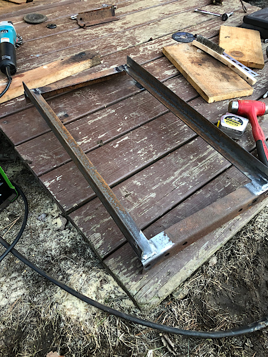

Just fixing up the seat frame on my 1940 Allis B and noticed that it seems really low when it’s mounted on the tractor. I was looking at some pictures of other tractors and it seems like some had taller angle iron to get the seat height up. Is everyone welding brackets or using taller angle iron to get the seat height up? The original angle iron mounts are only about 1-1/2 x 1-1/2”. Thanks

Could someone tell me the angle iron dimensions for the taller B seat and the overall seat frame width? Thanks

seat frame is 28.5 inches wide.. Multiple holes so you can slide back or forward mount.

This was exactly what I was looking for! So helpful Steve!
