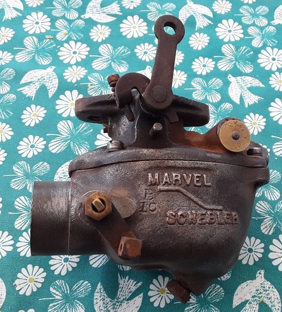

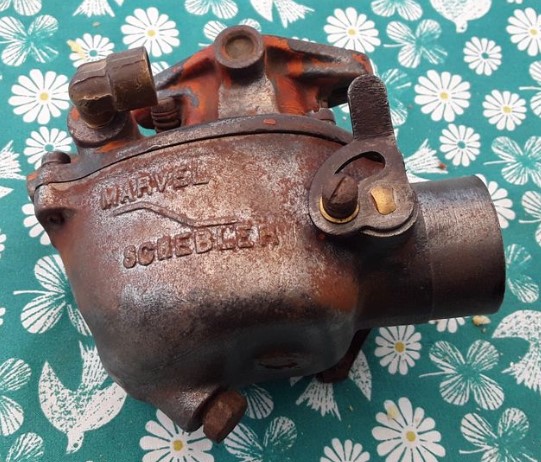

Hi
What are the different Marwall carb on the model C . I have a Marwall TSX152 , what are the differences with the TSX154? and others?
