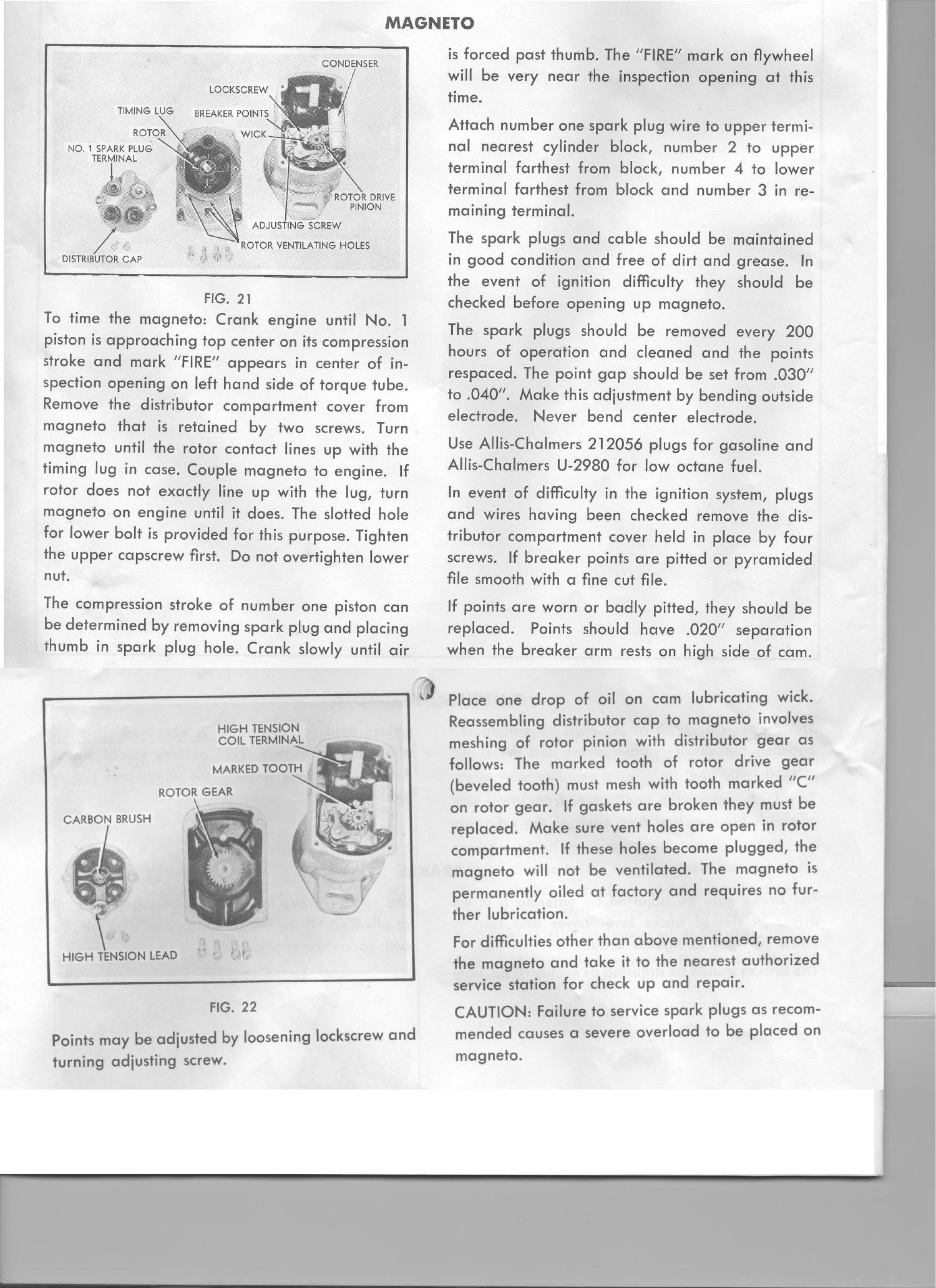

Thanks to all of you for sharing info on setting the timing for my Allis-Chalmers model B tractor.  I have studied the documents and  followed your instructions(getting the piston up on #1 and setting the rotor to the timing mark).  Unfortunately, I still have no fire to the spark plugs.  FYI the I have the red timing mark on the steel gear but the A and C marks are not present on the fiber gear in the cap.  I tried putting oil on it but it just isn't there!
I found a used cap in a junk yard yesterday.  Fortunately the A and C marks at very clear on the cap.  Hopefully this will fix the problem.  I will keep you informed.  Thanks again.

So far, you have not thrown a lot of money at your problem, which is good.  You might want to read the manual at the following link until you can comfortably picture how all of the parts, instructions and suggestions fit together:
http://www.magnetoparts.com/mag_docs/fm/j4_inst.pdf
