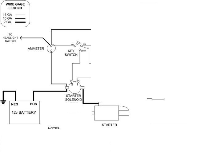

If you decide to eliminate the present push switch and put a STUD on the starter... Then you buy a SOLENOID and mount it between the battery and the starter... BIG wire to the solenoid.. BIG wire fromt  the solenoid to the starter... SMALL power wire to a BUTTON or KEY... and then a small wire from the BUTTON to the solenoid.. Small wire carries a little current the pulls in the SOLENOID and it powers the starter..
Here is a portion of a diagram that shows the battery, starter, solenoid and a key ( or button)... 12 or 6 volt, pos or neg makes no difference.

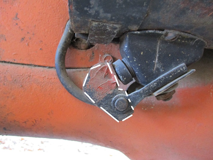

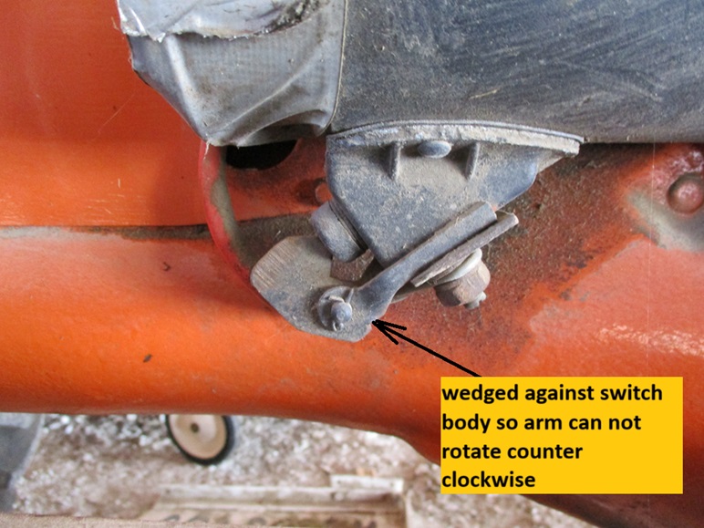

i havae a couple B tractors that i have MODIFIED with a starter solenoid.. I left the original starter switch on the tractor and made a little wedge and set screw thah holds the switch CLOSED all the time. That way it can not arc.. I have a solenoid and run the BIG CABLE from it to the original terminal on the original switch.. Didnt have to install the STUD by doing this.............. but i also use a 12v battery so the AMPS are much lower than on the 6v system..... that is a possibility for YOU , switch to a 12v system and should be a lot less LOAD on your starter switch.

Steve any chance you could post a pic or a diagram on how you modified the switch?
Points: 88225
Post Options Post Options   Thanks (0) Thanks(0)   Quote steve(ill) Quote  Post ReplyReply Direct Link To This Post Posted: 16 Jan 2025 at 12:27pm
Mike, here are a couple pictures of two different starters. The whole goal is to replace the PUSH arm on the switch with a different arm that HITS the switch case at the BOTTOM and will not rotate... at the same time the other end of the arm needs to PUSH the button in for contact.. I have made a couple and if they dont PUSH hard enough on the button, you can spot weld a tit on it and then reinstall.. in one photo you can see i just slide a piece of sheet metal in the contact point to get more push on the switch.. and then put a drop of RTV on it to hold in place.....
First one i made had a nut welded on the top and a 1/4 inch screw pointed at the BUTTON.. and you just screwed it in to hold the button down... These are much simplier, once you get the dimension right.

Thanks for posting. So you replaced the the switch lever with a new piece to hold the switch in engaged position then wired solenoid etc. Seams easy enough.

Post Options Post Options   Thanks (0) Thanks(0)   Quote steve(ill) Quote  Post ReplyReply Direct Link To This Post Posted: 16 Jan 2025 at 3:32pm
yes... the old switch ALWAYS ENGAGED takes the place of installing a NEW STUD....Dont seem to arc or wear as long as it is Always engaged.
