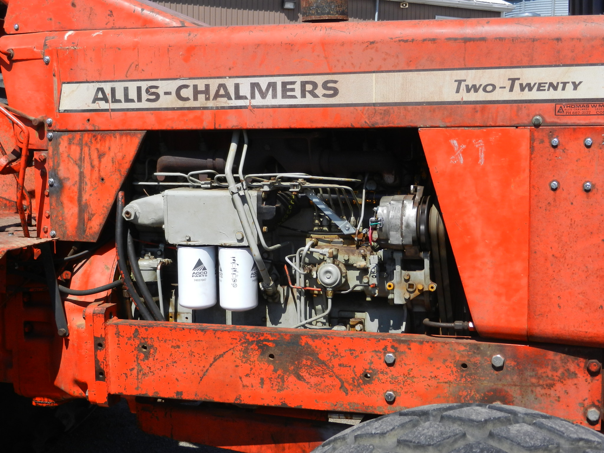

This is a factory built 3500 MK II industrial engine that I installed in my 220. Minemec pump-starts real good. 190 hp on dyno with factory pump setting.
Jordan(OH) View Drop Down
Location: Celina, OH
Points: 1559
Post Options Post Options   Thanks (0) Thanks(0)   Quote Jordan(OH) Quote  Post ReplyReply Direct Link To This Post Posted: 12 May 2015 at 11:00am
Calvin, where is the shut off on that pump?
Points: 8510
Post Options Post Options   Thanks (0) Thanks(0)   Quote SteveM C/IL Quote  Post ReplyReply Direct Link To This Post Posted: 12 May 2015 at 12:32pm
Jordan I believe it is on back side opposite throttle lever.One on the 301 out in the shop,I could go look.Mine uses a pull cable.Pull is on ,push is off.
Calvin Schmidt View Drop Down
Location: Ontario Can.
Points: 4529
Post Options Post Options   Thanks (0) Thanks(0)   Quote Calvin Schmidt Quote  Post ReplyReply Direct Link To This Post Posted: 12 May 2015 at 1:23pm
It is a pull to run - push to stop mechanical control.  The diaganol bracket that you see
on the running engine holds the control cable.
Edited by Calvin Schmidt - 12 May 2015 at 1:28pm
Points: 1559
Post Options Post Options   Thanks (0) Thanks(0)   Quote Jordan(OH) Quote  Post ReplyReply Direct Link To This Post Posted: 12 May 2015 at 10:05pm
Thanks, I see it now.  Little different setup than what Ford used.
