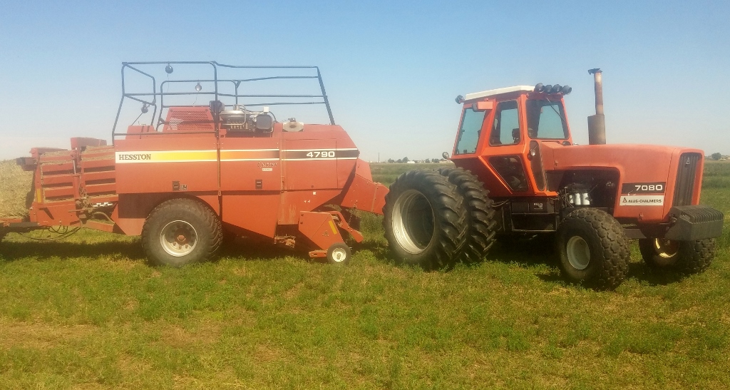

Also, here's a picture of the old gal on the baler.

Post Options Post Options   Thanks (0) Thanks(0)   Quote Lonn Quote  Post ReplyReply Direct Link To This Post Posted: 07 Oct 2015 at 10:43am
Too good to throw away

Post Options Post Options   Thanks (0) Thanks(0)   Quote TREVMAN Quote  Post ReplyReply Direct Link To This Post Posted: 07 Oct 2015 at 10:44am
Picture is worth a thousand words...Look, there is a reason you paid 15k, its a pretty nice tractor for what, 35 years old? If it were me, I'm 49, Id rebuild it and tune the high idle down as recommended. Should last a long time, jmho, Trev.
