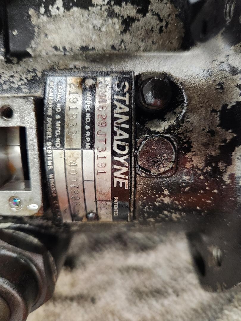

·         I’ve attached a picture of the injection pump below.
