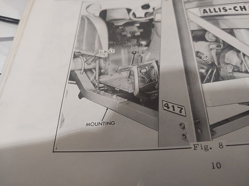

D-15 and D-17 are attached similarly at the Rear.
Both are an Angle Iron clamped to the underside of the Rear Axle with a 3/4" 'U' Bolt.

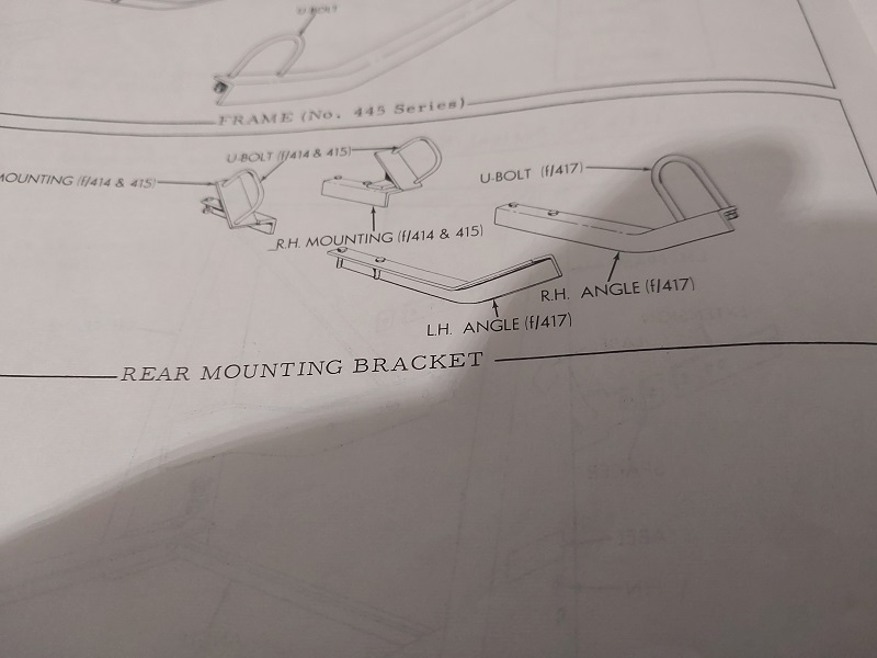

Post Options Post Options   Thanks (0) Thanks(0)   Quote Kenny L. Quote  Post ReplyReply Direct Link To This Post Posted: 29 Nov 2024 at 2:26am
Couple of pics.

Post Options Post Options   Thanks (0) Thanks(0)   Quote Kenny L. Quote  Post ReplyReply Direct Link To This Post Posted: 29 Nov 2024 at 2:30am
I made my brackets to put a 415 loader on my D17, if I get out to the shed today I'll try to reminder to get some pics.

Post Options Post Options   Thanks (0) Thanks(0)   Quote Gary Quote  Post ReplyReply Direct Link To This Post Posted: 29 Nov 2024 at 12:57pm
Yes Kenny those are the sketches and pictures I was referring to.

Post Options Post Options   Thanks (0) Thanks(0)   Quote DaveWisc. Quote  Post ReplyReply Direct Link To This Post Posted: 30 Nov 2024 at 11:02am
The brackets are different angles got 15-17

Post Options Post Options   Thanks (0) Thanks(0)   Quote DrAllis Quote  Post ReplyReply Direct Link To This Post Posted: 30 Nov 2024 at 4:20pm
It is important on a D-17 series to make sure that small angle iron clip is attached to the big U-bolt and on a fender mounting bracket bolt to keep the U-bolts from spreading apart.
