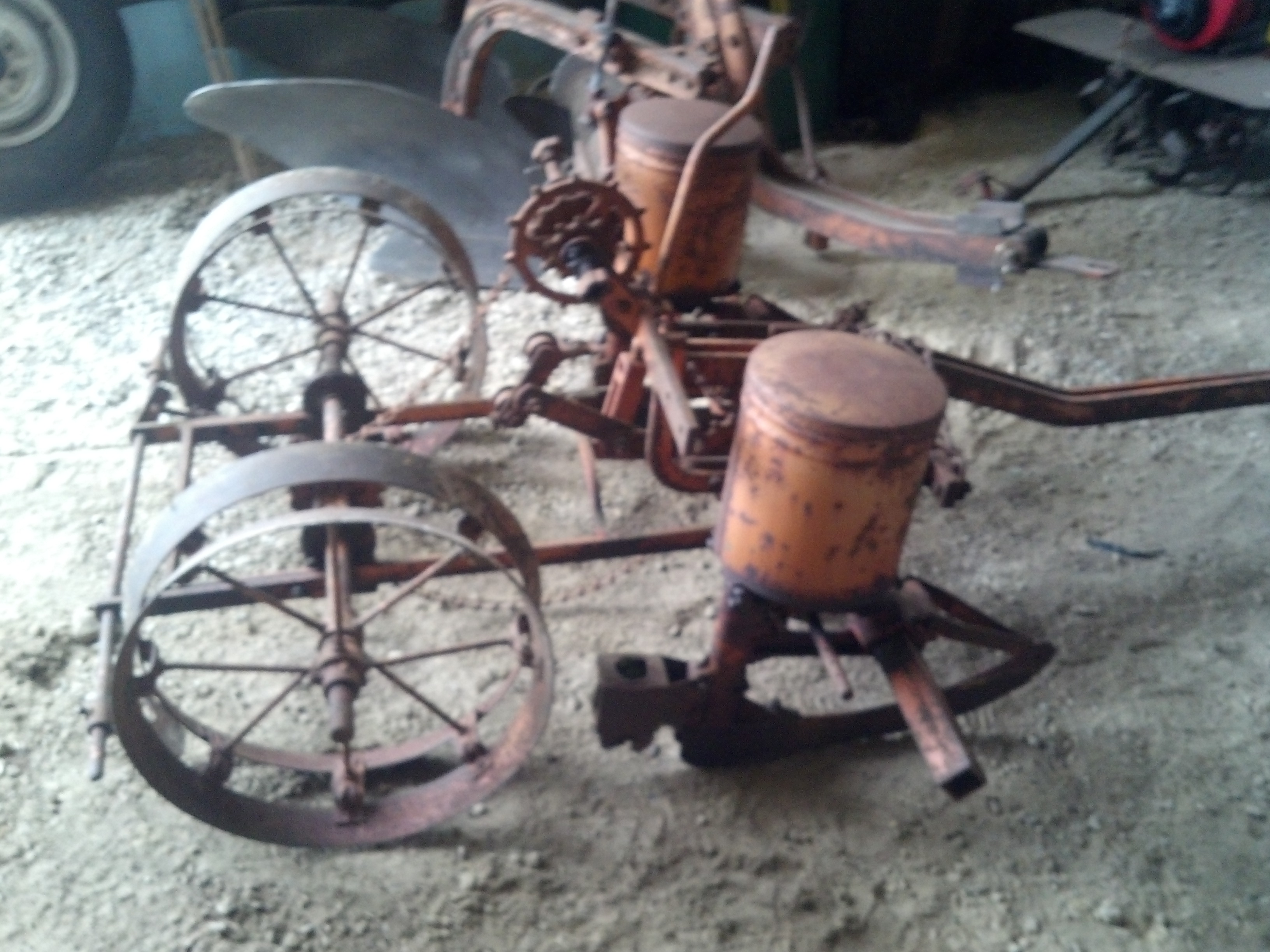

 almost done with the painting. thought i would share as i like looking at other peoples.

 this is the plate that is in the seed bin. is this o.e.? it says lustran b-soy 3x so i'm thinking it's a soybean plate. i would like to plant corn and would like to find a diff. plate. i looked on ebay and the ones i found that look like these are for jd. would they work? it is 6 7/8 inches across. thanks for any help.  Troy

It is a soybean plate. Corn plates are common, lots of diff sizes though. Lookup Marshall Machinery on ebay (new2youtractorparts) and ask them what they have available. They have a lot not listed and they are pretty good on pricing. They will probably be listing a bunch soon, now that planting season is just around the corner, it might be good to beat the crowd.

Troy. your drill planter looks fantastic. would bet it will plant 150 plus bta for corn and 50 plus bta beans. thanks for the memory.......

thanks for the kind comments. i ordered a set of corn plates off ebay last week that are for a jd but looked the same. if they don't work i'll try new2youtractor as listed in one of the above post. now that i know how to post pic. i'll start sharing some of the wood dragging photos with the d14 later. thanks again!       Troy

Those are John Deere plates that you have in the picture.  Those white plastic inserts that go inside the plates are made to allow the use of John Deere  plastic plates in an Allis-Chalmers planter.  If you go to a place that sells seed corn, they probably have many different sizes of plates that they would give you for whatever corn you bought.  There are many different plates for corn, there isn't just a "corn" plate.  Most seed corn will list the suggested plate to use on the tags attached to the bag.  I suggest that you use one size larger plate than is usually suggested for best results.  Here is a video of my father planting corn with his two row AC planter.    I can probably answer most questions you have about your planter.  Also, here is link to Lincoln ag products that have all the different plates and the adapters to use the john deere plates in an AC planter.  http://www.lincolnagproducts.com/

troyl...that yellow plate pictured is a john deere plate

thanks for the info. DanD what sprockets should the chain be on?  i'm just using it to plant my food plots (about 3 ac.). i set it as wide as i could 42" and am planing to plant a row in the middle of each pass to end up with 21" row spacing. Or is that a bad idea? also thought about dragging in some soybeans before i plant the corn. thanks .  Troy

Well, if you don't have a manual you'll just have to play a little until it's putting out a seed at the spacing you want.  On my father's planter, I believe he has the chain on the largest sprocket on the drive axle and smallest sprocket on the shaft that drives the planter plates.  With 16 cell plates that gives one seed as you turn the press wheels about the distance from one spoke to the next.  Just play with it and you'll get it close enough for your purposes.  You may have different sized sprockets on your planter than what my father's planter has, too.
I found this picture of my dad's planter and you can see the sprockets on the rear and which one he uses.  I know he uses the smallest sprocket on the plate driven shaft which I think is either a 7 or 9 tooth sprocket.

Here's my two row planter. I plant corn with the chain on the biggest back drive sprocket and the chain on the 7 tooth front driven sprocket it drops about 9" apart. In this shot I had it on the middle driven sprocket and it droped about 12" apart.
