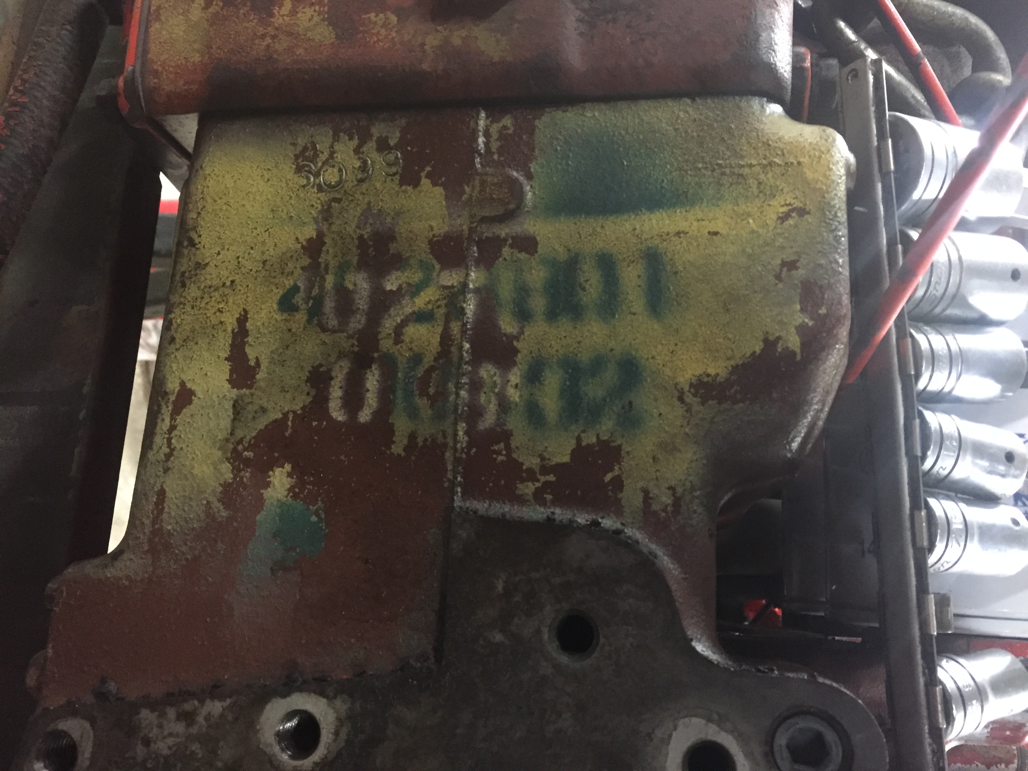

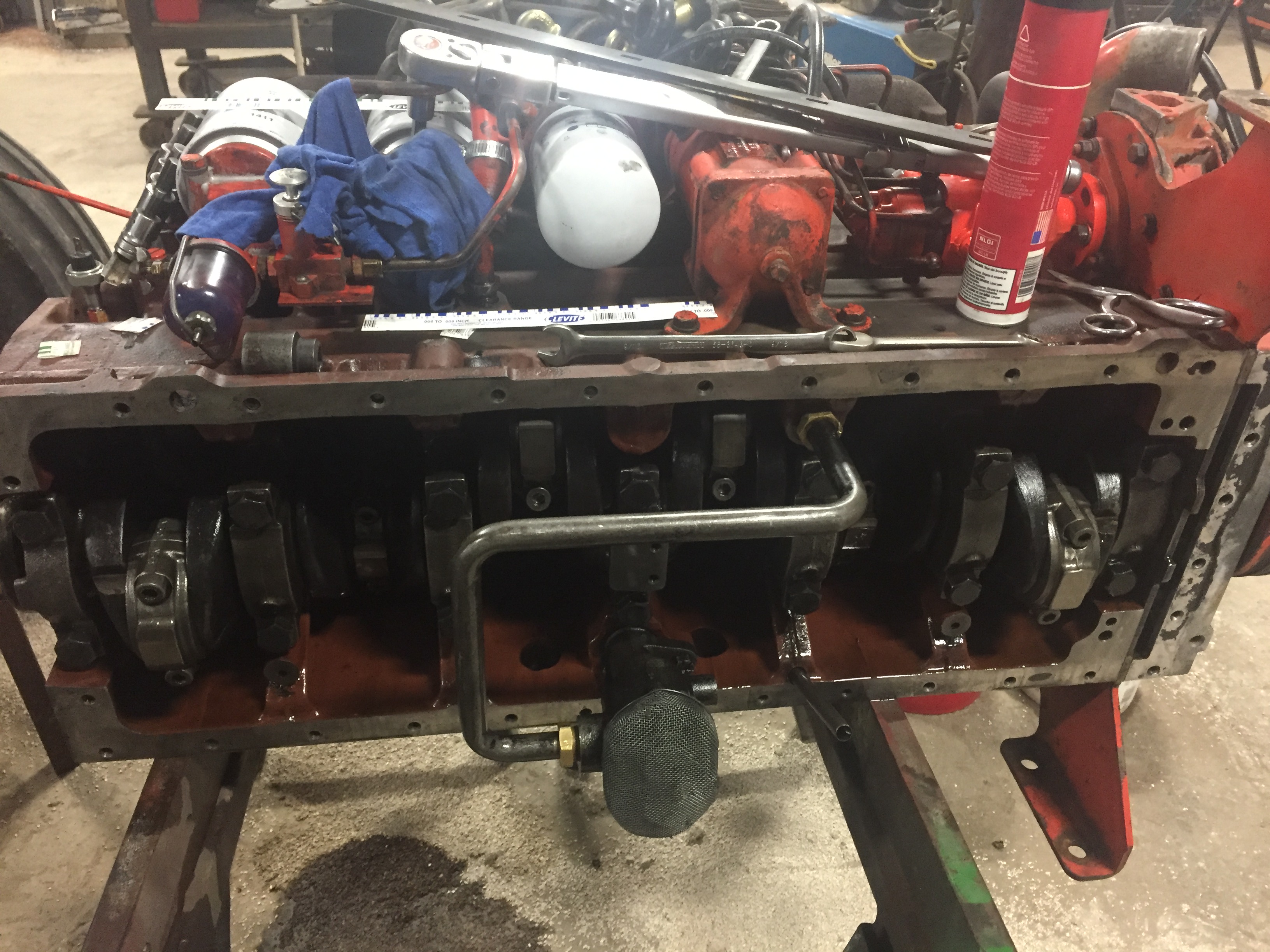

I’m hoping this works to post pictures of my engine.
Thanks Bill.

Points: 8667
Post Options Post Options   Thanks (0) Thanks(0)   Quote SteveM C/IL Quote  Post ReplyReply Direct Link To This Post Posted: 08 Mar 2021 at 8:07pm
When Doc weighs in he'll know whether those are pump mount holes up front and I'm wondering about that front cover. Almost doesn't look like there's room for the pump gear to get to the crank gear and still fit in the pan.
Looked at parts books and the mount and dowel holes are there for the crank pump. Looks like the driven gear will fit up there although book list 2 diff frt covers...cam VS crank drive so I don't know. It will all interchange so you may have to get frt cover along with pan pump and related hardware. Don't give up now!

That is the old style block which does not have piston cooling, unless some one drilled the block.                MACK
