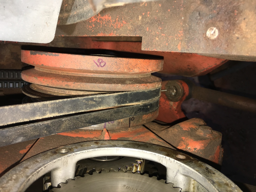

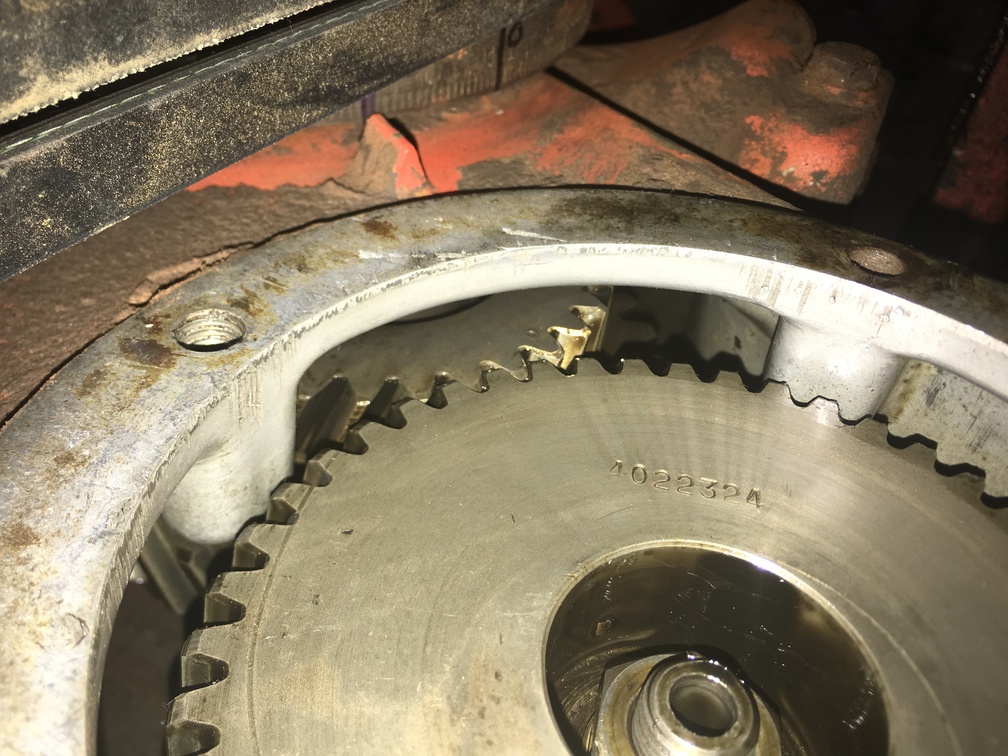

Removed pump and injectors for overhaul after turning engine till marks in pump window aligned and timing mark on gear cover was at about 20 deg BTDC.  Did not turn engine while waiting for rebuilder.  Did remove the pump drive gear cover plate but 90% sure I did not disengage those teeth from idler gear teeth.  Reinstalled pump and injectors, bled lines, started tractor, and it sounded pretty good, but white smoke.  As I waited for it to warm up, diesel started leaking from the exhaust manifold so I shut it down knowing unburnt fuel was present.
  So what have I done ?  Messed up timing ?  Injector issue ?
Please refer pics for clues ...

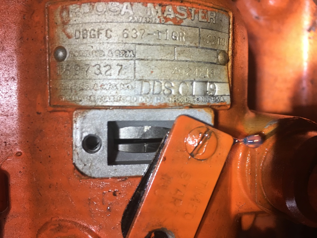

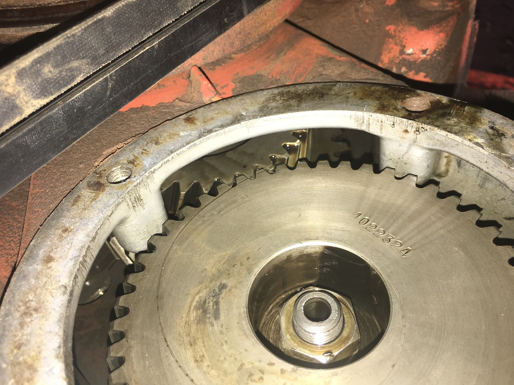

The idler gear has a timing dot but the pump drive gear doesn't have a dot that I can see, but does have a helical shaped mark around the rear face.  Is this a timing mark ?  Service manual shows a dot aligned on both gears when timed correctly.
With the pump timing marks aligned and the pointer on 18 BTDC per service manual, the dot and helical don't align.

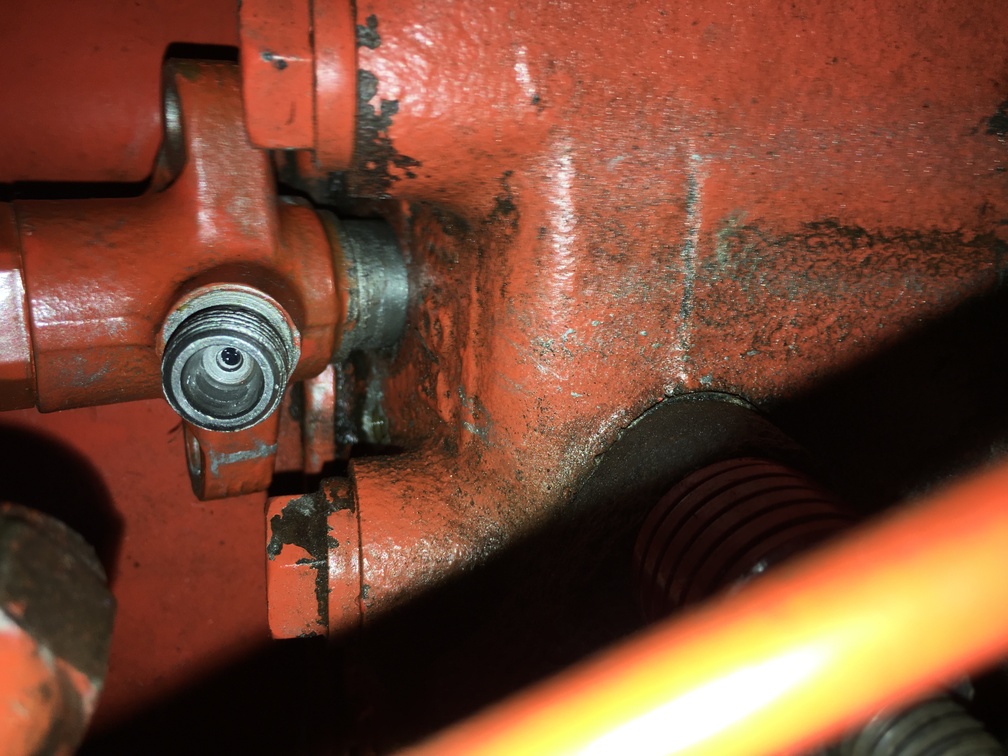

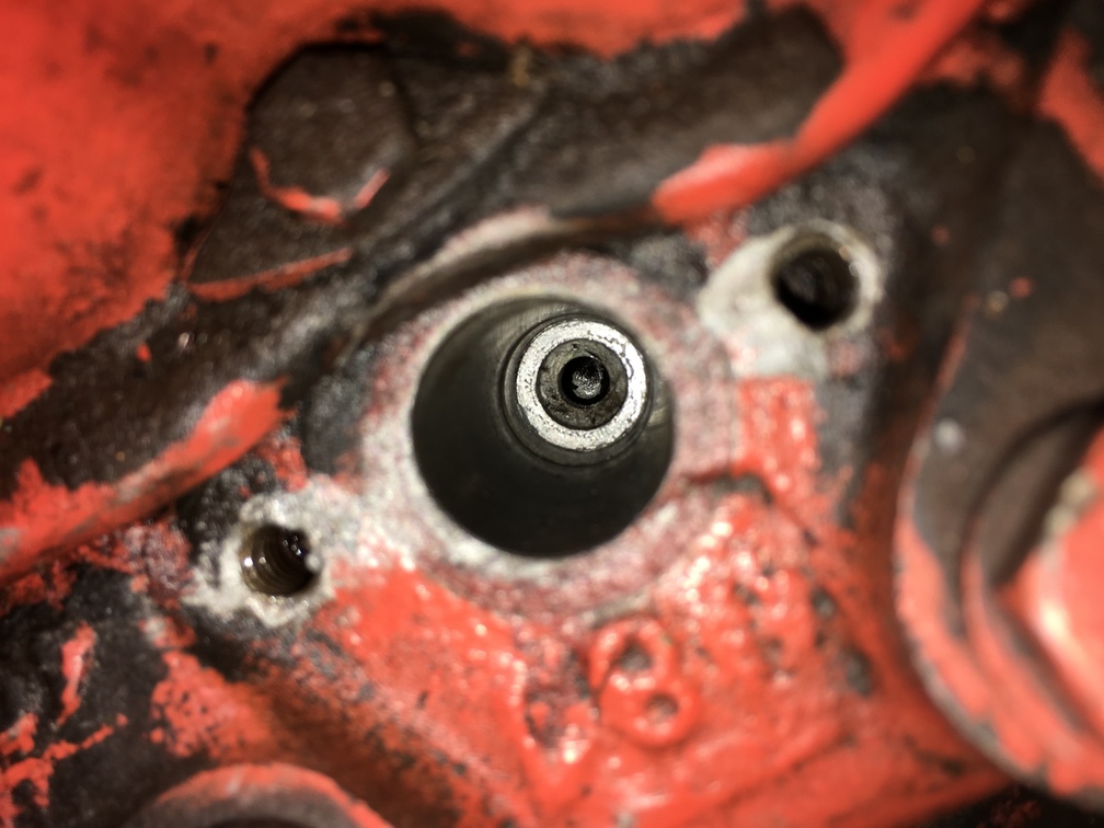

Also, it doesn't look to me like the injectors are seating properly even though I verified no crush washers left behind and new ones on each injector.  Are they supposed to sit this high ?  (I removed foam dust seal for the photo)
With the roosa marks aligned and on 18 BTDC the idler gear dot is out of position.
I never had the drive gear off the shaft but perhaps inadvertently slipped some teeth.  So, any ideas on how I can get this back into time would be appreciated.

if the pump times at 18deg and that pointer is there and the pump marks are lined up,it should be in time no mater what the dot says.  Always check timing marks vs deg pointer after turning engine by hand in direction of rotation to eliminate any gear backlash. That helical is a machining mark from a sloppy operator. Can't explain the raw fuel. With pump and injector rebuild,that should not happen.

Also, 90% sure the outer shiv on the harmonic balancer hasn't slipped in the rubber which would put the timing marks out of position.  Haven't found the alignment marks on the dampner with a mirror but still looking to verify.
With injector # 1 out, and the dampner timing mark on top dead center, the piston is up, but valve cover not removed to verify valve position.  Is it possible the pump is out such that it is injecting at top of exhaust stroke ?  Don't see how it could run that way but that would push plenty of diesel out the exhaust manifold.  Also I'm confident the drive shaft dot was aligned correctly when stabbing the pump onto it.  Ugh I hate puzzles.

11GR times to 24*. Your rebuilder should be able to offer some guidance.

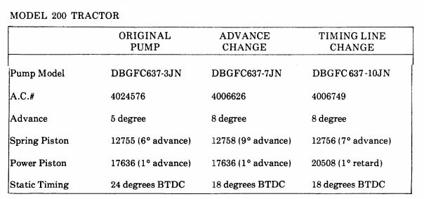

DBGFC 637 11GR...….every digit/letter means something.  11GR describes what type of timing advance that is built into the pump.  The static pump timing differs with the type of automatic advance. Some model 200 tractors are timed at 24 degrees BTDC and some are timed at 18 degrees BTDC.  IF FOR SOME REASON THE ADVANCE HAS BEEN ALTERED BY A PUMP REPAIR SHOP, THEY ARE TO REMARK THIS INFO SO THE PUMP GETS STATIC TIMED PROPERLY.  Timing an 18 degree pump at 24 degrees will eventually burn piston bowls.

The 11GR was first, then came the 3JN with same 5* advance. Then AC wanted to go to the 8* advance so the engine could be timed down to 18* instead of 24 for easier starting. The 7JN and 10JN are essentially the same, just the position of the line in the window is altered.

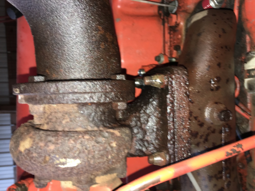

Allis 200 now set at 24 deg, started easily but still have 1 injector streaming fuel I guess because white smoke exhaust and fuel running out of exhaust.  Loosened the exhaust manifold and determined it to be cylinder 3 or 4 so I'll pull them and see what the heck.

Took the injectors from the wet exhaust manifold, sent them back to the shop that repaired them, then sat back rehearsing my speech on how they should pay attention to their work.  They were returned with a note saying injectors were fine, just plugged up with anti seize.   Oops ... once I had an injector connection gall so I like a bit of anti-seize on the connection.  Since I wasn't paying attention I let it get into the tube and plugged newly rebuild injectors ... foolish but that's me.  Still have some white smoke but no moisture in the exhaust path so hoping any other plugged injectors will clean up with fuel additive and time.  If not, I'll take them back to the shop, tail between my legs.
