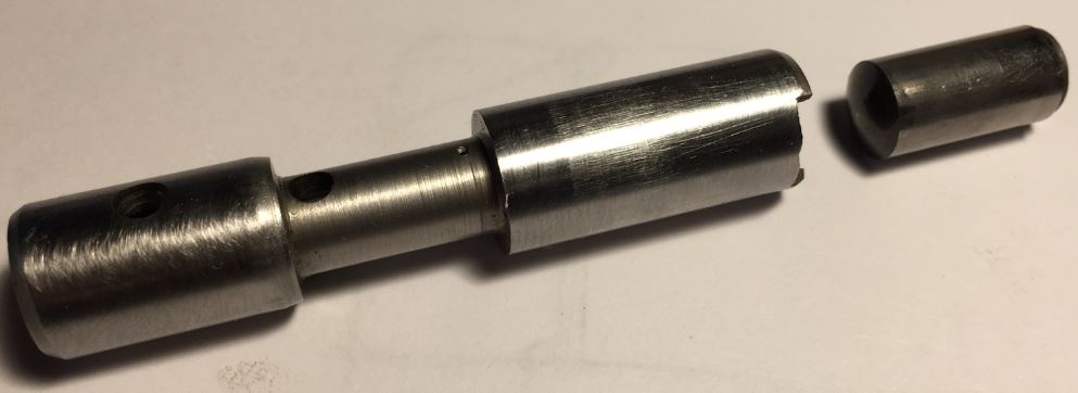

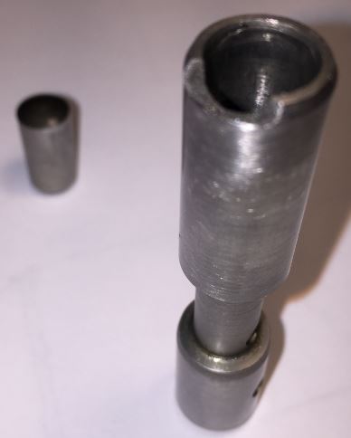

Thanks so much for the information.  The pto does turn easily by hand and will check pressure.  I'll look for something behind the battery box even though my hydraulic pto doesn't have any linkage or lines going that way.  Verified all of the hydraulic lines go to and from the correct place.  Made my way through the PTO valve and found the control rod side prone to stick so polished it up.  On the other side found a chunk gashed out of the relief valve spool which made the plunger stick.  Didn't find the chunk.  It was hard to tell if the tiny orifice was plugged but it may have been.  Would this damage make the pto system completely unresponsive ?  Is this a salvage yard only part ?

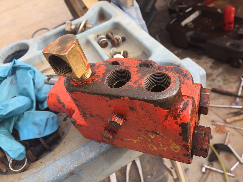

Since the PTO valve damaged parts are mated to the parts, I got a valve outa salvage.  The one sent is the greater than SN 4001 version but perhaps it will work.  Strangely the caps were switched compared to my old valve.
Does anyone know if the cap with the notches (larger internal cavity) aligns with the control rod side or the relief valve spool side of the PTO valve ?  (See photo)

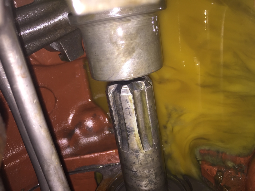

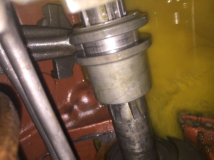

Post Options Post Options   Thanks (0) Thanks(0)   Quote smitty78 Quote  Post ReplyReply Direct Link To This Post Posted: 26 Jan 2019 at 3:58pm
And, Mack, attached is a pic of the PTO shaft with the power shift valve and plate removed ... the shaft is disconnected from the coupler but I thought perhaps it was moved to engage when the PTO is engaged.  If not I should use a bar to slide the coupler onto the shaft correct ?  What makes it stay in that position ?  Thanks.

Post Options Post Options   Thanks (0) Thanks(0)   Quote DougG Quote  Post ReplyReply Direct Link To This Post Posted: 26 Jan 2019 at 4:13pm
Theres springs and balls that hold the coupler in one spot, the balls fall into detent holes that holds them

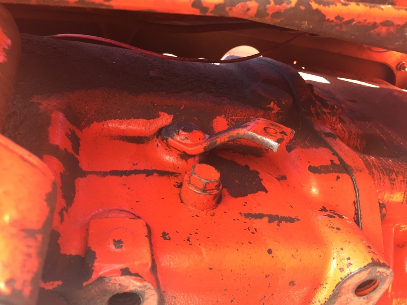

Post Options Post Options   Thanks (0) Thanks(0)   Quote DrAllis Quote  Post ReplyReply Direct Link To This Post Posted: 26 Jan 2019 at 4:35pm
There is a short lever behind the front of the battery box. I can see it in the picture.

Post Options Post Options   Thanks (0) Thanks(0)   Quote smitty78 Quote  Post ReplyReply Direct Link To This Post Posted: 26 Jan 2019 at 4:39pm
And of course there is a metal strap with a hole in it, attached to a shaft between the battery box & housing.  Initially looks like an anchor point for something.  Doesn't look like an adjustable lever, no handle, nothing in my owners manual about it, no stickers or cast features to hint which direction engages or disengages, but it's there and it moves the coupler into engagement by rotating the hole in the strap toward the radiator.  Likely didn't need a new valve at all but live & learn.  I owe you guys coffee & pie, if only there was anywhere to get it anymore.
