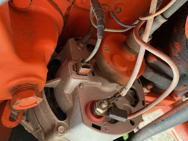

Here’s what I have…

That is a 10DN series alternator

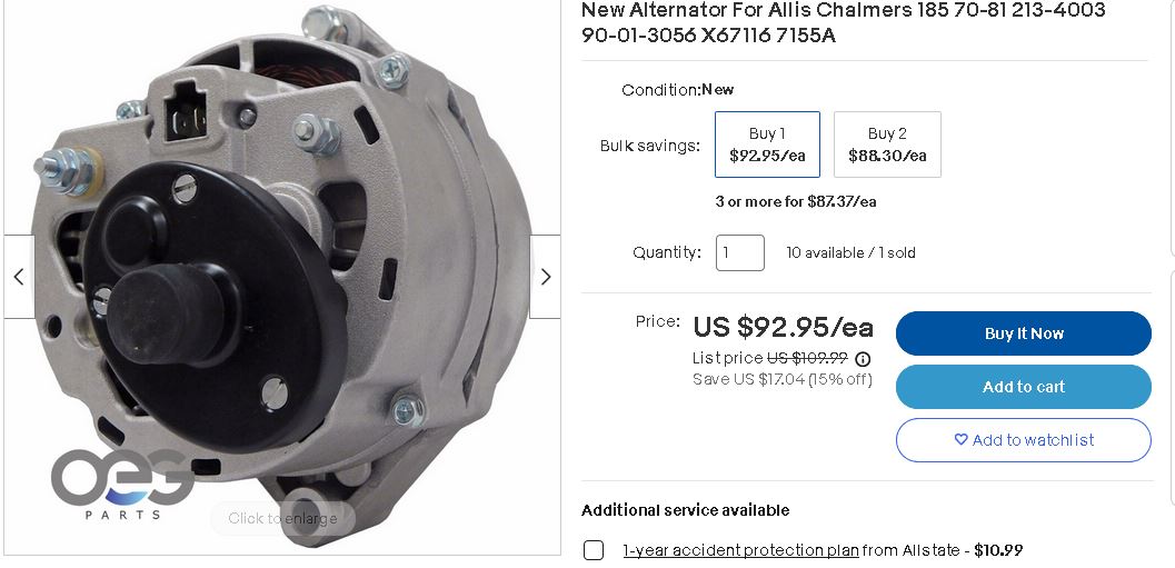

Finding another 10DN is NOT a difficult issue... JEGs advertises a 100A externally-regulated unit with single-belt pulley for $130...
But finding one fitted up for the tachometer drive is the challenge. The back of the case needs to be drilled and tapped for two retention screws, and IIRC the drive requires an extended shaft and seal protruding from the rear, to which the tach drive is connected.   I won't claim to the Allis application on this, as I've only seen this on a scant few marine diesel engines that were NOT Allis... but I DO know that the drive unit's gearing must match the alternator's belt drive ratio in order to generate an accurate indication on the mechanical tachometer.
Here's one of unknown sourcing...

If I'm not mistaken, the DN alternator on a 200 with cab and air was a 55 Amp version, which was enough for most all applications. I put some 72 Amp windings in a few tractors that were pulling the Allis air planters. The planters blowers required additional output. The DNs are easily rebuilt and parts are cheap and readily available.

One other issue I encountered on my 190xt was the pulley that came with the new alternator did not match the old alternator.  It was a smaller circumference so I took it off the old one to put on the new one.  However, the spindle was not long enough on the 10si alternator.  Then I found out I had Delco 12si.  Since those Delco 10si models were used in tons of applications, I am not sure you will get the correct matching pulley.  You also may have to shim a new the alternator to get the belt alignment correct.  You won't know until you install it.
I assume I had the tach drive unit at one time but somewhere along the way, mine got replaced without the tach drive.  My tach does work but wondering how long it went without working?  Explains why I only show 4700 hours on a tractor that definitely has more hours than that on it.
I decided to get the old one rebuilt.  That way I know everything matches.  Bad news about rebuilding is that the tractor can't be used unless you get a temporary alternator just to keep the fan belt on.  I need to finish some hay fields and then I think I can take it off for a few days while waiting on getting rebuilt.
I think you are into hay season as well.  To keep the tractor running, you might try getting a DN alternator and then rebuild the old one then make the new one a spare.  Obviously with an air conditioner and cab, you need an alternator pretty quickly if it isn't working.

The 100 series tractors & 200 came with Delco 10 DN alternators, no cab 32Amp, Cab 55Amp, rotor drilled/tapped for tach drive.
 I had a local rebuilder that if 32A alternator failed made them over to 60 amp by installing higher capacity stator as I was running extra electrical. After starting in cold weather they peg the 60 A ammeters for a couple minutes. Most electrical rebuilders should be able to do this if requested.

Ok I have the DB electrical 63 amp with tach drive on the way here. Believe advertised as a 1 wire. Don’t laugh at me but how do I wire this?

Agco shows them but think it’s HyCapacity. part number 79004867n

ONe wire is just the BIG LUG and connected to the BATTERY terminal . ( or the HOT lug on the starter solenoid).. Same as a 3 wire, but you dont have the two spade terminals.
Captain... one curious question... On the present alternator, why is there only one wire on the two spade connector ?  Looks like wire has been modified.... Guess its still working that way !!
Edited by steve(ill) - 24 May 2023 at 8:59am
Points: 8667
Post Options Post Options   Thanks (0) Thanks(0)   Quote SteveM C/IL Quote  Post ReplyReply Direct Link To This Post Posted: 24 May 2023 at 9:07am
Thats how my 220 is plumbed with external regulator. I only have 1 BIG wire on the hot post
