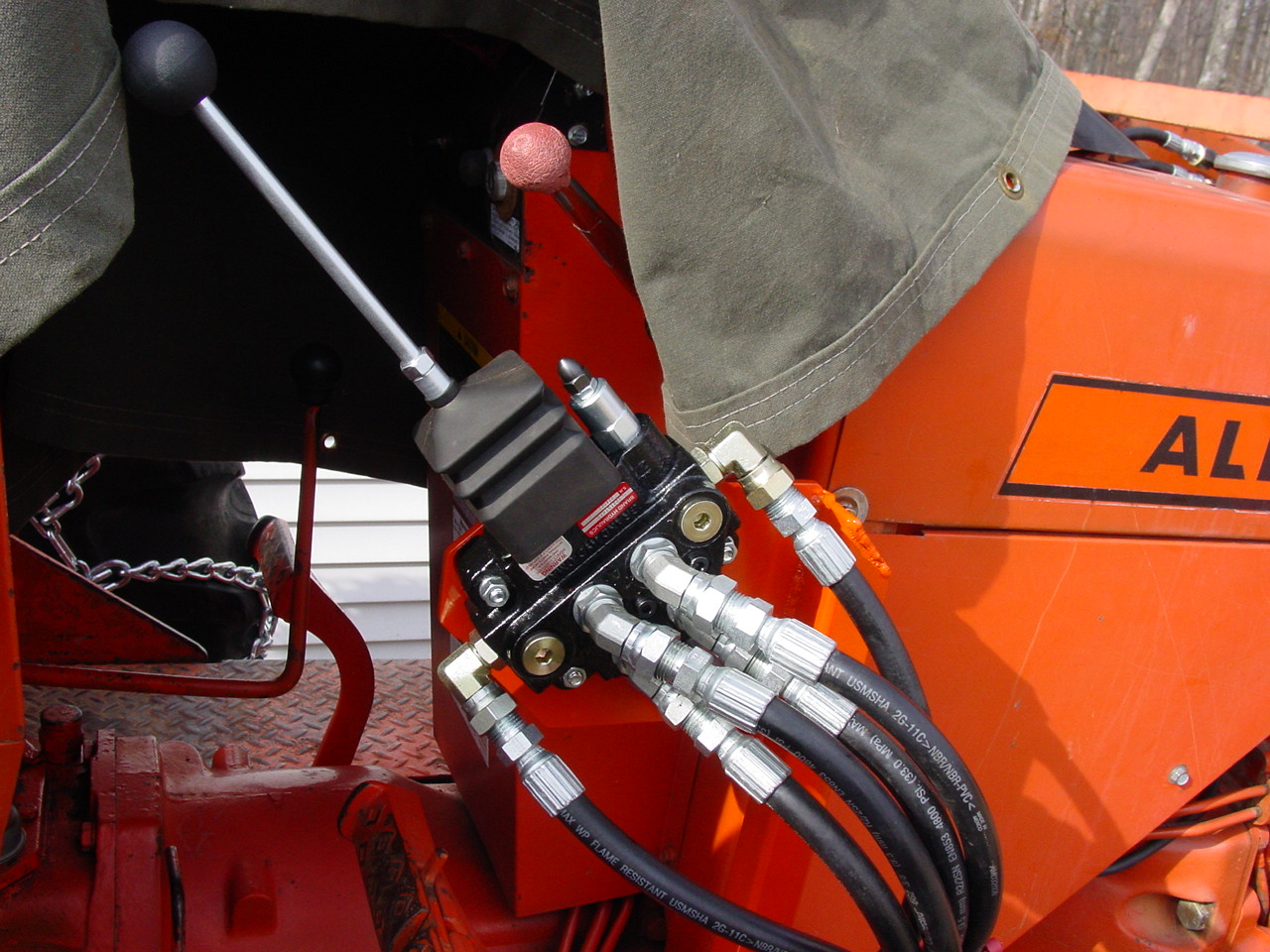

We went to the hyd valves and put a t fitting where there is a L fitting than ran the hoses along the right side with some shut offs so you could lock the loader in up possition and still use the rear remotes Niel
Points: 33912
Post Options Post Options   Thanks (0) Thanks(0)   Quote DMiller Quote  Post ReplyReply Direct Link To This Post Posted: 11 Mar 2012 at 2:10pm
I went as far as to break the union under my 180 and set it up as power beyond for a loader control valve as I also wanted live loader and two remotes.
