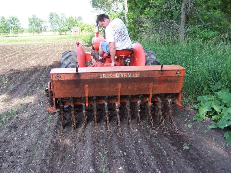

Tom, the spring coils control about 6-8" of vertical movement on each disc and seed tube across the width of the drill. I would think it's no issue. We have used the same drill on both WD and D14 without any issues on hold positions. I think the vertical travel helps make up any differential with the hold pos. Of the tractor. If that makes sense...

Ok so I am trying to get my head around it....on a conventional drill the openers are held uip by the tires on the drill....you then drop the openers from that point to get the depth you want...what on the ac serves as the "tires" so to speak?  I assumed it was the hold position on the hydraulics....

Not a big fan of 'Hold Position' on the WD pump either. However, It is a non-factor with the All Crop Drill. Set the chains for the depth you want, adjust the spring pressure on the disc openers, and run with the lever all the way down. I use my drill every year, mostly in the spring. Handy as a pocket on a shirt!
