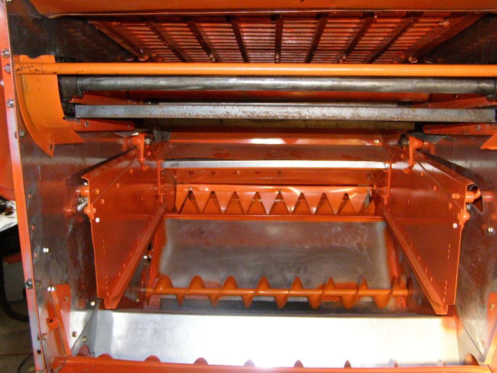

You notice anything peculiar about the grain pan pic?
1. Has a cleanout.
2.  The above shaft that turns the pitman is NOT wrapped in the metal from the above table.  That is because the shop bent the wrap too tight. Cut it off. For the better anyway. One can now keep that shaft well oiled so it can be pulled out during servicing. Otherwise when wrapped by the tin, you cant get to it and it gets rusty, making pull out problematic.  Verision 2.0 of that table will have a bent hood over the shaft instead of
the complete wrap around giving it the sheilding but still can grease it.
3. Of course you guys see the fan bearing replacement....is "off the shelf" but was still hard to size. The distance between the center of the bearing and top flange had to be tight so the fan isnt mounted too low causing it to hit the fan housing bottom. Only found this one make that had such spec.
