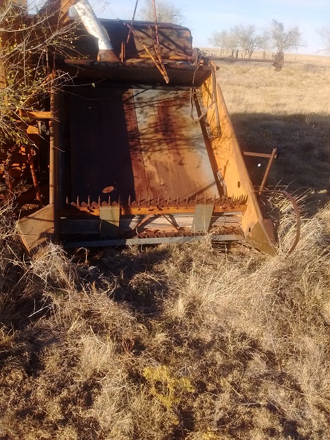

Post Options Post Options   Thanks (0) Thanks(0)   Quote Michael V (NM) Quote  Post ReplyReply Direct Link To This Post Posted: 28 Apr 2019 at 4:12pm
Here ya'll go my 60 with the bundle topper attachment

It basically turns the combine into a stationary threshing machine. After using your grain binder, you take the bundles to the combine, and holding them horizontally, pass them down over the bundle topper sickle bar. Then the heads go up into the combine to get threshed, and you don’t have to run all the stalks through.

Post Options Post Options   Thanks (0) Thanks(0)   Quote Michael V (NM) Quote  Post ReplyReply Direct Link To This Post Posted: 28 Apr 2019 at 7:53pm
yes, for such things as kaffir, or higeri(sp), red top cane, and others that got really tall
these were prolly bundled when the stalks were still really green, but seed had matured, the 'butts' were ground in the hammer mill, or fed whole to the cattle..
 a really dangerous attachment,,, as you can prolly tell by looking..
I can remember this being used by my grandparents....

Post Options Post Options   Thanks (0) Thanks(0)   Quote DennisA (IL) Quote  Post ReplyReply Direct Link To This Post Posted: 28 Apr 2019 at 8:54pm
Looks like item #9 attaches to the cutter bar.
Hope this helps!
