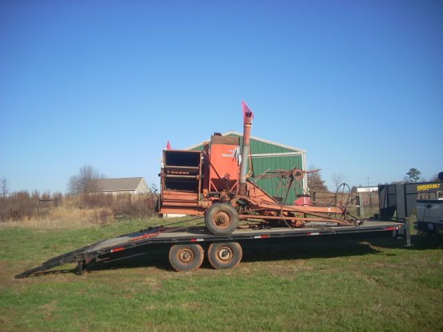

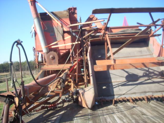

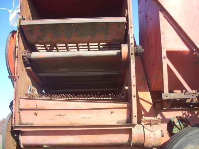

   Here's Regie's 66:

   Regie, the bin and auger are from a 60 or an early 66 "Small Bin". The hydraulic lift and crop lifters are nice bonuses !

The origianl owenr did not want the bin, he had his son tie the bags.  His son had to tell me all about it.  Later when he couldn't find any one to tie the bags he had to get a bin.  It cost him $200.00.  I met the great grandson who is very interested in the machine and wanted to restore it.  but he in HS  (9th grade, I think) and does not have the resources.  In some ways I'd like to return this one to like new condition and get it back to the great grandson.  I think that would be something to be able to farm with something your great gradnfather farmed with.  In the meantime I need it to harvest a few things for me.
At one time he had a mentally challanged man doing the bag tieing, but the man could not operate the lever so the daughter rode along to flip the lever.

We have 3 All crop 66's. Our parts machine has the same bin attachment shown in
your pictures. That would be the small bin (18 bushels) with the auger on the front of
the bin. I am not using that set-up now. If you need parts for that bin and auger let me know. We use our 66 in soybeans every year, and it works great. If you want to see a picture of the 66, go to www.allcropharvestor.com and it is on the home page.
The soybean screen has 3/8 iinch holes in a staggered pattern. We bought all of our parts, drapers, belts, etc. for Tom Yaz. Every part worked great and shipping was very
fast. Tom shipped some extra screens to. Follow all of the set up instructions it should
work great. Do not forget to grease each spot. (About 80 zerks.). Also when done, at the end of the day loosen the lower draper, lift up the upper draper, and loosen the
large main drive belt. Make sure all elevator chains and grain drag chain have the proper
tension. We loosen the rear belt in the off season for storage. Good luck.
