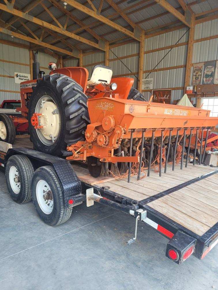

Posting photo for Dr. Allis
Looks like a nice rig

Wish my 18 hoe pull type looked that nice!
Points: 21458
Post Options Post Options   Thanks (0) Thanks(0)   Quote DrAllis Quote  Post ReplyReply Direct Link To This Post Posted: 8 hours 27 minutes ago at 7:52am
From a friend of mine to make some parts that aren't available any longer. The drop tubes for the grass seed are just 3/4" black plastic water pipe. He uses a heat gun to soften the top to get it to slide into place and trims/cuts to make it fit like the original. Not shown, but he has also made a piece of angle iron to tie them together on the bottom to keep the spacing accurate. Info to help some of you who may need some repairs in this area. Thanks, Aaron for posting. Thanks, Ed W. for the picture and parts design update.
