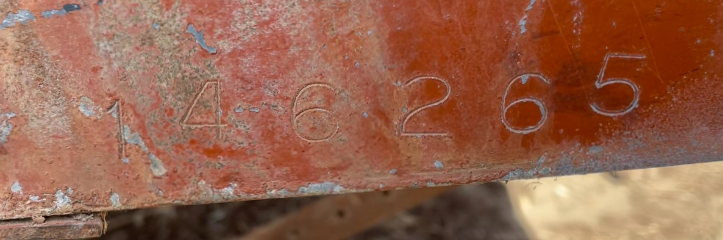

The wood is in decent shape and the paint isn’t too bad but I only got a picture of the serial number. It is missing a few parts I think so I might have to go to the one I found in a creek near by and rob them off it (land owner gave me permission).
From my estimate it is around a 1948.

Your estimate on the year is close. According to the serial number table in Swinford's book it is a 1947, about 3000 before the end of that year. HTH.  Don Jr.

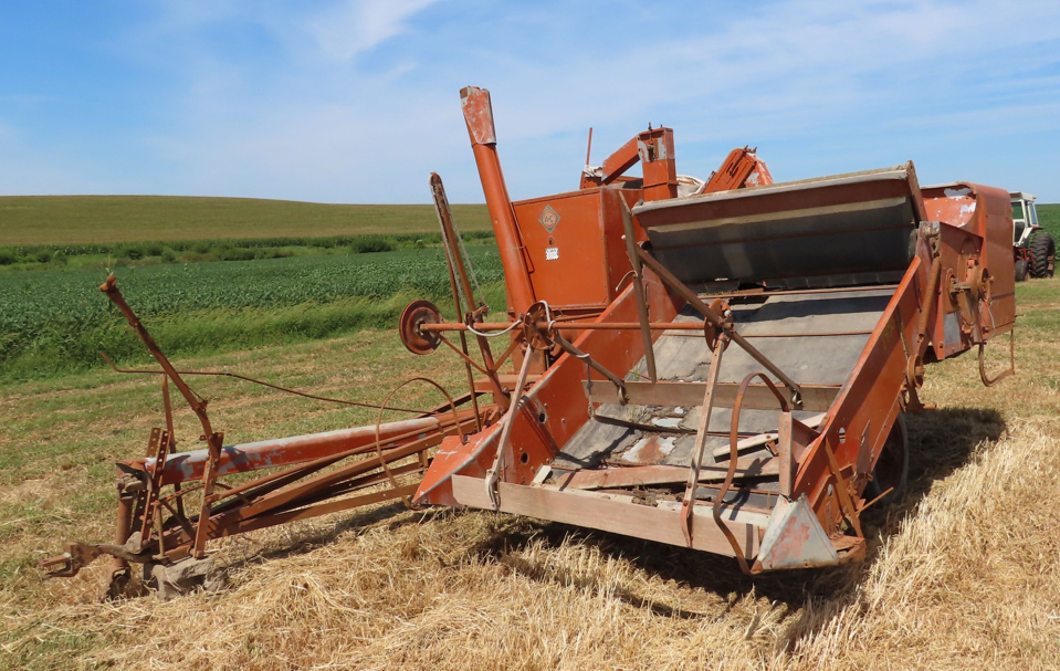

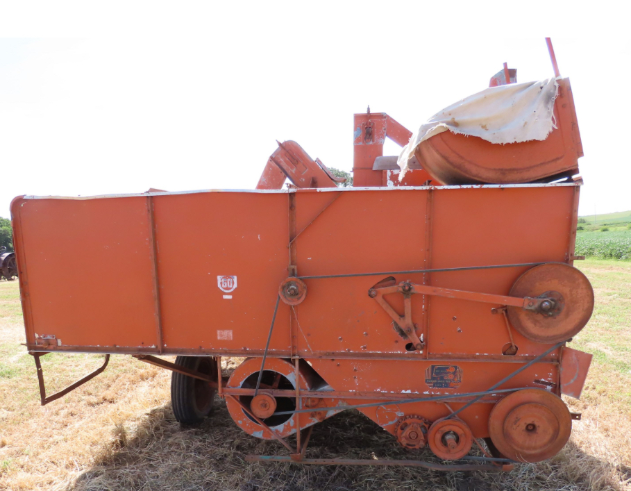

Here’s some pictures I found of it from the auction site.

Is any of it aluminum?

That looks pretty good from the pictures. Is anything rusted out underneath? (concave sheet metal, cleanouts, etc.)

Not sure what to top is made out of but it almost looks like stainless steel..
Could be aluminum, the way the paint comes off.
Didn’t think much of it until now.
The clean grain trap was completely rusted as when I tried to remove it it went to pieces.
Been trying to flush the gearbox of sludge, put diesel in it to soak in hopes of it coming clean without removing it.

I was under the impression that it was galvanized steel.

I think the bottom of the head is galvanized steel.

Swinford's book says that's a 1947 model. They used a lot of leftover war aluminum on 60s around that time, get a magnet and go over the machine. You may be surprised how much of it is aluminum. Let us know what you find. It's not uncommon to find some with pieces here and there, but judging by the way the metal shines in the areas where the paint flaked, it looks like this one could have quite a bit.

That is very interesting, I’ll definitely look into it, maybe that’s why it’s in that nice of shape.
The wood is nearly perfect other than a couple of bars in the shaker from critters chewing.
Even the wood slides for the draper was in good condition until the other guy tried to remove the head, he cut the bolts and the wood there.
Ended up swapping them out with my other All Crop which had steel ones. Figured they’d be better.

Just confirmed that the whole back shell is aluminum…

That’s very interesting. I can’t say that really adds any value for most people, but if someone were looking for an aluminum model that would be quite the find having that much on one machine.

I think it is an advantage, no rust on it to repair!!
My 60A is all steel and it has quite a few rust holes.
