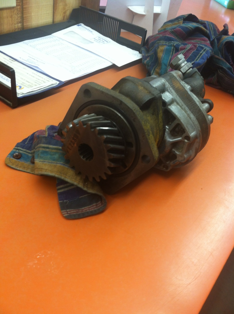

Hi, I am new to the Forum. My sons' and I bought a Franklin logger 1967, 170L with a 3500 195H Allis Chalmers motor. According to a book my older son owns the engine was built between 1963 and 1969. The Hydraulic pump that operates the steering and blade went out. It is a Webster pump but no serial number on it. Also the only number on the Franklin was on the Tranny case which is a Rockwell ; 170L and a B in a circle. I have been spending days to weeks trying to solve getting a pump but everyone wants numbers. The pump fastens at one end to the motor by the front of the engine by the Flywheel. Does or has any one out there ever dealt with this? We are still using the skidder to drag logs. Thanks!!! Janice in Central PA.

If you could post a picture of the motor, hyd pump, etc, Someone here should be able to ID it...

A picture would be helpful. I'm sure that Webster pumps are no longer available. You are  best to take it off and a good hydraulics shop should be able to find you a replacement that will work.

Post Options Post Options   Thanks (0) Thanks(0)   Quote matthew123 Quote  Post ReplyReply Direct Link To This Post Posted: 08 Jun 2015 at 8:57am
uploads/13881/IMG_0932.jpg

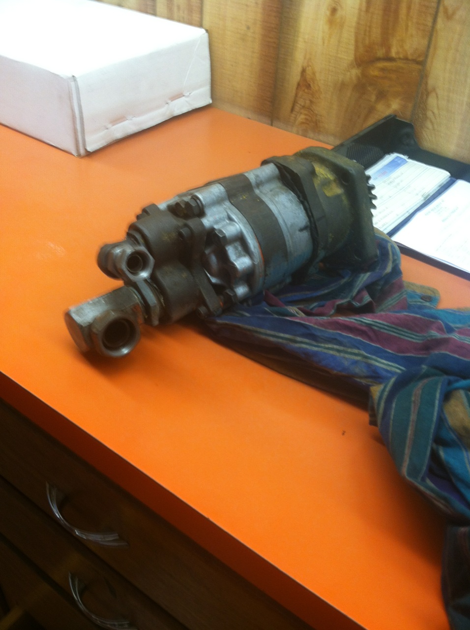

Post Options Post Options   Thanks (0) Thanks(0)   Quote matthew123 Quote  Post ReplyReply Direct Link To This Post Posted: 08 Jun 2015 at 8:59am

Post Options Post Options   Thanks (0) Thanks(0)   Quote matthew123 Quote  Post ReplyReply Direct Link To This Post Posted: 08 Jun 2015 at 9:01am
Above, is a few pix i posted for emulady.  This is the exact pump off of her machine.  Please keep us posted.  Additionally, i received a phone call today from davco, they received the pictures as well.

It looks like the pump mounts on the left side of the engine the same place as the hydraulic pump does on this engine in a D-21, 220, or 210. A hydraulic pump from one of the three tractors that is a bare back should work or any other standard mount pump should mount to that adapter. Will need to be close on GPM.

If you can figger out what the system GPM, and PSI is, surpluscenter.com might have something that will fit.  Take the drive piece off the end, and see what the pump end looks like...
