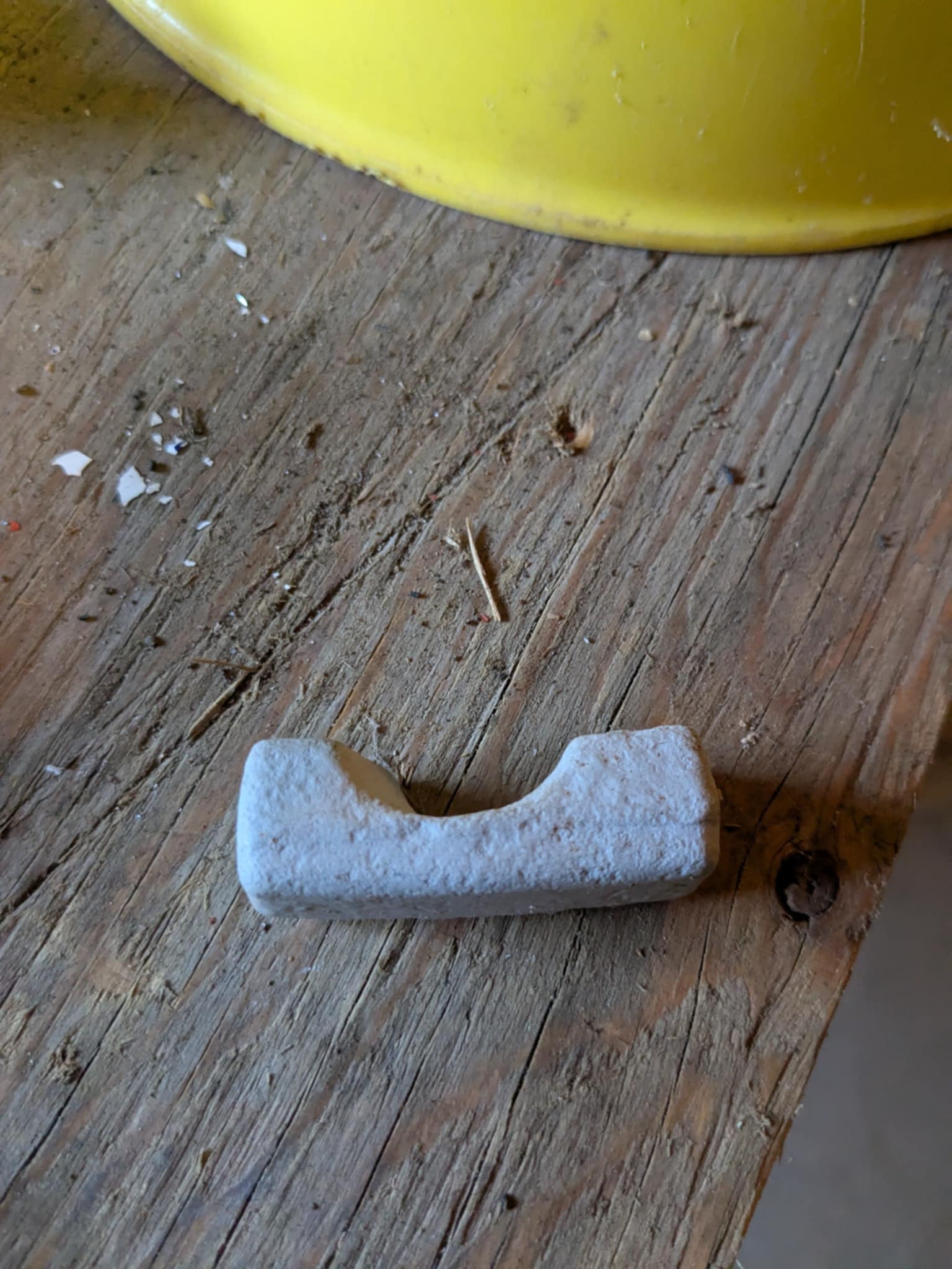

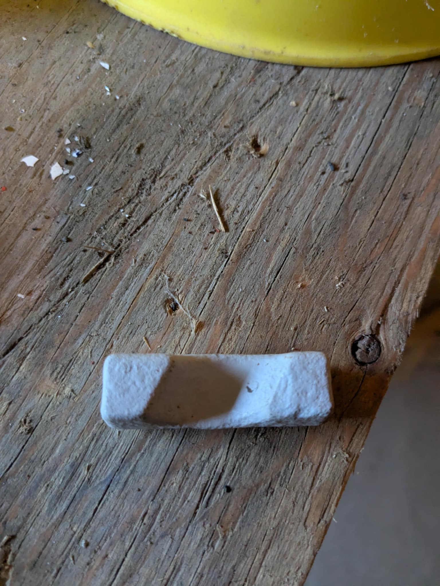

I have a restored AC WD with adjustable rims. I cannot keep them tight on wedges and the kept sliding in. Are the wedges in the rim clamps worn enough to not tighten enough. Looked for new ones but can’t find any.
Points: 22769
Post Options Post Options   Thanks (0) Thanks(0)   Quote DrAllis Quote  Post ReplyReply Direct Link To This Post Posted: 25 Aug 2025 at 1:51pm
You are missing a piece at each eccentric location. The eccentric doesn't contact the wheels rail. There is a piece that goes between them. It is called a "block" in AGCO Parts books.

Also needed are the stop blocks the go on the drilled rail with a bolt.
