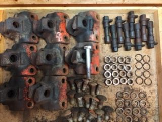

Has anyone ever bought an empty acetylene tank? I bought acetylene and oxygen a few months ago because mine were both near empty. Went to use them today to heat the eccentrics from my D14 and the gas regulator is on 0. The oxygen is on 2000. I just hope the dealer believes me that it must have been empty when I got it or leaked since then. Anyone else ever have trouble like this? It was over $100 for both refills.
