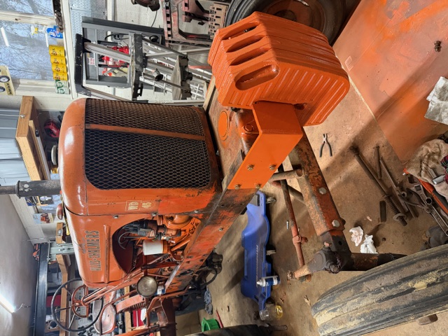

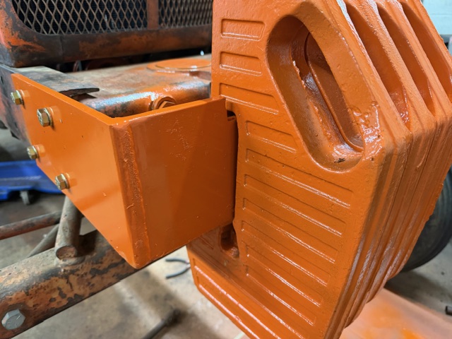

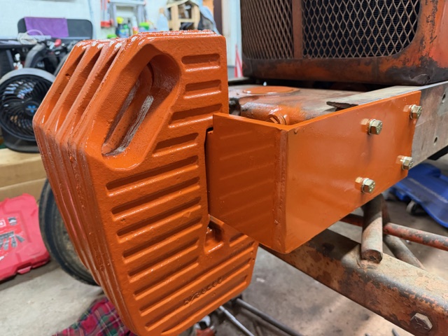

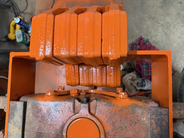

With the help of a local welder I made up this front weight bracket to hang these suitcase weights I had.  I also cleaned up the weights and painted everything Persian Orange #1. The bracket weights 30#'s and the four weights are another 280#'s.  This should make lifting heavy equipment and pulling the three bottom plow a little more efficient!
It really looks like it belongs there!

It looks good and will help a lot. That's about the rihgt amount of weight.
They were made for 3 or 4 slap weights at 75lb each. You weights are a litlte farther forward so that will help a little more.
