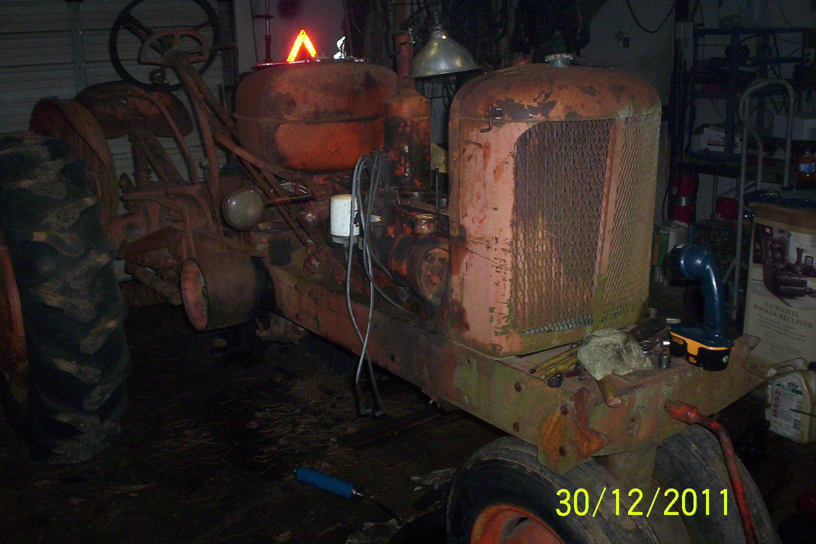

your wd should have a 202 cu in engine, same as the wc but with the added benefit of a hydraulic over ride clutch. tell me, where did that lil allis come from..........

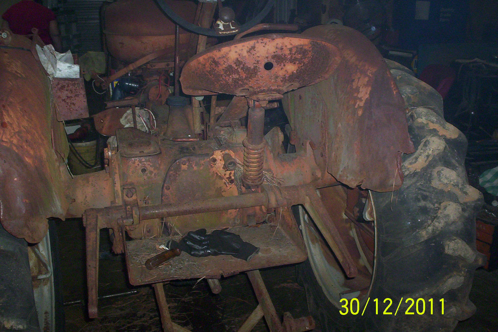

Early WD's had the serial number stamped in the top surface of the differential housing on the right side of the left brake cover. You may want to look there if there is no number stamped on the aforementioned place.
Follow the link to see exactly where the serial number is stamped.
http://people.clemson.edu/~wsmth/SNLocat/ACSN4.htm
332600 is a 1952 engine block but that doesn't necessarily mean the tractor is from that year. A lot of these old things have had transplants. Another possibility is something happened to the rear end and a new housing was used to correct the problem. Replacement housings would not have had a number stamped in at the factory.
 So if there isn't a number where the pictures show after scraping off old paint, you may have a 1952 with a replacement diff housing.

Welcome to the Allis group.  You have a WD.  The serial number is on the flat area above the adjusting screw for the left brake.  The screw is about three inches below the brake cover.  It will start with WD______.

Number should be stamped in the vertical surface right above your screwdriver handle.

Looks like a WD to me, the serial number is stamped on the real axle housing below the left brake access cover.

front viewback viewI know this is not a new subject but here goes.... Obviously I'm new here. I have what I believe to be a WD. I have the engine S/N WD332600PA. I have searched the real axle and have found nothing but casting marks. It does have the straight shifter and the number in front of it is 200931. The number is cast into it though and not stamped; however there is a plate above the number that appears to read R-K-KL (it could be an A at the beginning), and there appears to be a 6 stamped in below the cast number. Can anyone help?trans number
