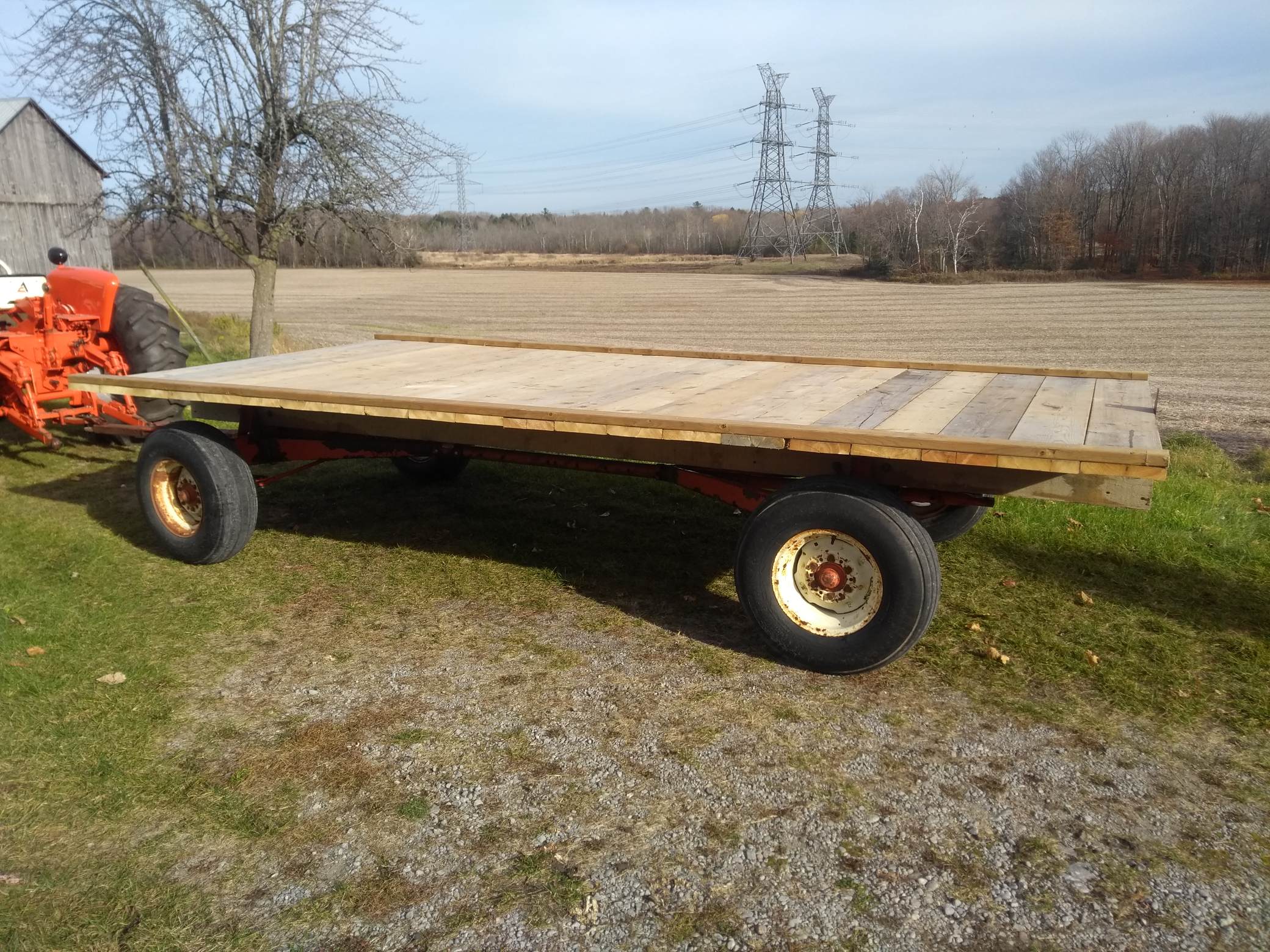

Mine has a 16' deck on it.  Used to be a forage wagon, but still has the standard length reach with the flattened end.

Dseries4, Thanks for sharing about your 800 gear & hay rack. It looks great. Thinking it’s fully extended? If so could you please measure it’s wheel base?
