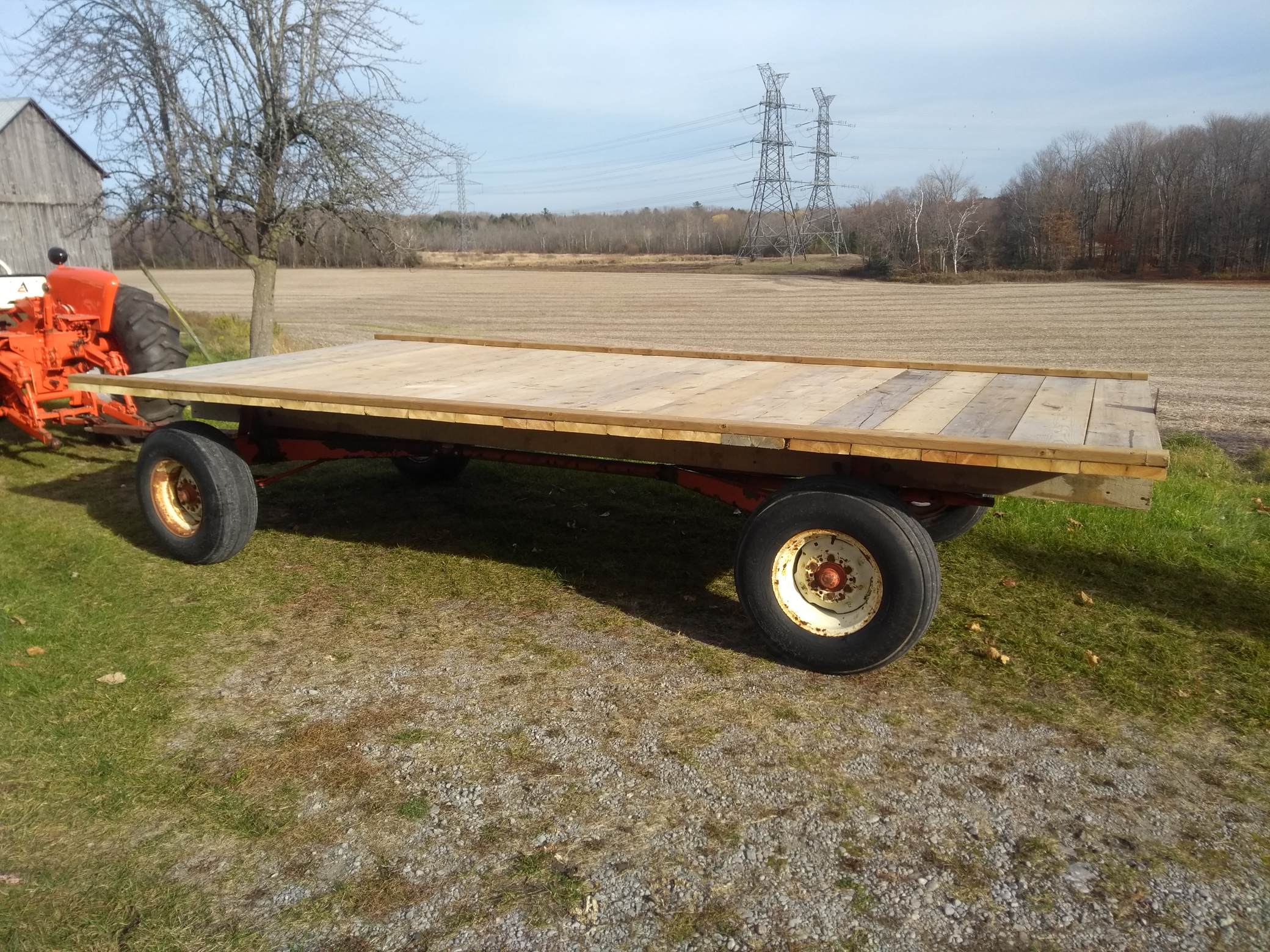

Mine has a 16' deck on it.  Used to be a forage wagon, but still has the standard length reach with the flattened end.

Post Options Post Options   Thanks (0) Thanks(0)   Quote AC7060IL Quote  Post ReplyReply Direct Link To This Post Posted: 26 Feb 2026 at 6:26pm
Dseries4, Thanks for sharing about your 800 gear & hay rack. It looks great. Thinking it’s fully extended? If so could you please measure it’s wheel base?

Post Options Post Options   Thanks (0) Thanks(0)   Quote DSeries4 Quote  Post ReplyReply Direct Link To This Post Posted: 28 Feb 2026 at 8:50pm
Exactly 11'

Post Options Post Options   Thanks (0) Thanks(0)   Quote DanWi Quote  Post ReplyReply Direct Link To This Post Posted: 28 Feb 2026 at 8:58pm
11 ft gear 1-2 ft overhang on the front and 3-4 ft overhang on the rear for a 16 ft rack.

Post Options Post Options   Thanks (0) Thanks(0)   Quote WF owner Quote  Post ReplyReply Direct Link To This Post Posted: 01 Mar 2026 at 5:47am
If the wheelbase is 11' (center-of-spindle to center-of-spindle), one foot of overhang on the front probably won't get you to the front of the rack being even to the front of the tire.
If the cross pieces on Myron's rack are 2" x 10", he has pretty close to 40" overhang from the center of the rear spindle. If that is the case, he should have about 20" overhang on the front.

Post Options Post Options   Thanks (0) Thanks(0)   Quote DSeries4 Quote  Post ReplyReply Direct Link To This Post Posted: 01 Mar 2026 at 7:53am
I haven't measured the overhang, but I do want to move it forward one of these days.  It's pretty far back and it has a long tongue, so there will not be any problems

Post Options Post Options   Thanks (0) Thanks(0)   Quote WF owner Quote  Post ReplyReply Direct Link To This Post Posted: 01 Mar 2026 at 8:11am
It looks ok to me. I have seen wagons with a lot more overhang than yours.
