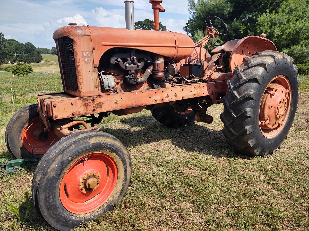

Hey all,  I have been wanting an Allis Chalmers since I heard some of our family friends talk about them years ago. Growing up we had a JD 2030 loader and a 1530 (which was the one I always used). Later on a large McCormick 4WD added. I just brought home a '54 WD45 wide front end and I am so stoked. I have been a car and motorcycle fixer for years and I can't wait to dig into the Allis. It will be a family affair too. She runs well, but of course will need some attention. Not sure about the patina to strip or restore/clear. Anyway, I'm in Western NC and look forward to the camaraderie. Take care and God bless!

Welcome to the group, there is a wealth of wisdom and knowledge on here with all the great folks. Your project looks good, I'd have a hard time deciding to paint or leave the wd45 in its work clothes, especially if I found a pair of front wheels in the same patina, all looks clean and original from the picture. Again welcome to the group and keep us updated.

That is one fine looking WD-45 and looks to be all original.

If it were me I would keep it the way it is - Original.

Congrats on your new find! That's a nice solid, straight Tractor you found. Looks good in its OEM work clothes. If you ever need any electrical components for wiring system for it, keep us in mind. Welcome to the bestest AC forum on the planet!

Someone sure bent the front axle perch. Something else had to bend to accommidate that!

that will be a good project its not a grease bucket thats a nice way to start

Looks good all around!
Mix up "shine juice" (YouTube vicegrip garage channel)  and wipe on a coat or two. Boiled Linseed oil and mineral spirits to thin. Let dry. Thinner coats better. Too thick and it remains sticky. Lasts a year outside or longer if garaged. Cheap, fast, and brings the shine while keeping patina. Much easier than a repaint.
No rear photos .. but the tractor gets a lot more useful with a three point hitch setup. There are many reasons modern tractors have Ferguson three point hitch designs. You can buy retrofit kits or work up your own. I posted images of the work up I used in an old post, uses a Ford 2000 lower arms, Kubota Tractor Supply verticals, and such.

What am I missing? How can it be "original" with an alternator mounted on left frame rail?

So all the parts on yours are from the year of production? I'd love to see your tractors then. You must have a giant stash of NOS stuff too. Can I buy some? Thanks. I can heckle too.

Great tractor, they helped bring AC to the front. In nice shape to be 70 years old! So the original genny gave out so someone went the cheaper route and put an alternator on it. No big deal, my D17 series I diesel had a alternator and a generator on it at the same time when I bought it! The reason was the generator also drove the power steering even though it no longer worked the electrical. Depends on how you want  your tractor to end up. Factory original, or updated to newer technology? Alternator is cheaper but I chose to have Steve@B&B Custom Circuits repair my generator so I could stay factory correct. The alternator was the first thing I removed. But you want to keep it? More expensive to repair the generator but I don't regret it at all. I had already decided to go down that road when I bought it. I repaired and replaced a lot of parts on it to get it to where it is today. I enjoyed the 8 month project so much, actually sad when I finished it lol. But now I get to farm with it and know that its going to be reliable. You have probably got a game plan and maybe a final decision on what your plans are. Its your tractor, advice is great on this site, what ever you do, enjoy it. You got a cool tractor with a lot of heritage.

Thank you. I was actually glad it was converted to 12 volt. I'd like.to keep it originally equipped as possible, but upgrades are welcome since I will be using it some. I have always have had a project usually cars or motorcycles for the last 25 years or so, so this will be a great learning experience. I'll be looking for some implements soon, but need to track down a draw bar and maybe do a 3pt hitch conversion for ease. I'll keep everyone up on my progress.
