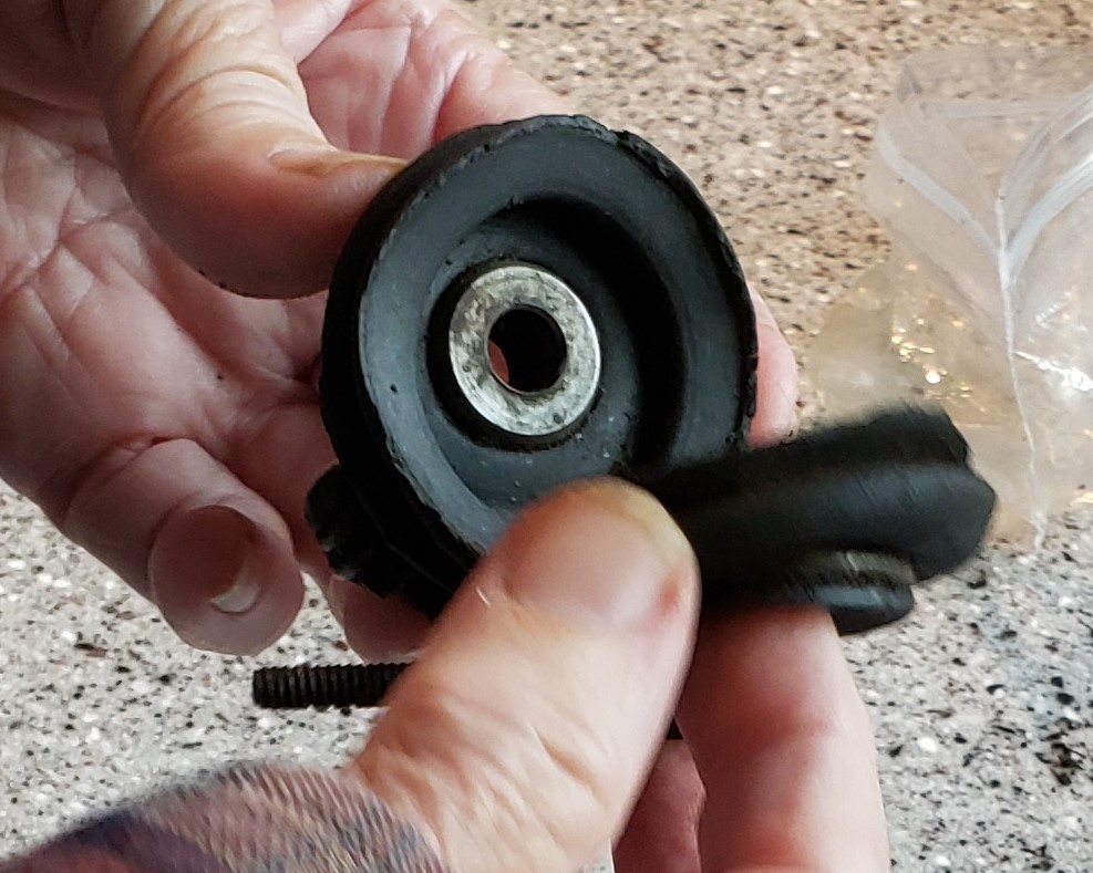

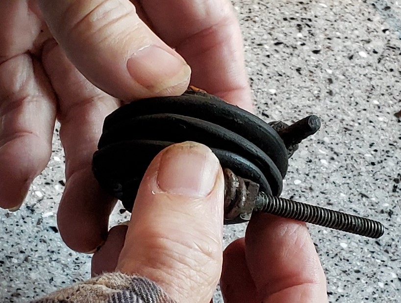

I am looking for a grease boot for an 1954 Allis Chalmers HD5 dozer. My dad calls the part it goes on a clutch brake. I believe it is a power transfer clutch boot. All the parts houses around our area have no idea what it is or what it’s called. Can anyone assist me in identifying this and/or give me a site where I can purchase one as this one is shot!

Try searching for rubber bellows or bellows boot...Wink

This boot should be the boot brake operating rod or the  small boot for locking plunger and should have some on racking

I believe these are available from Western Gear in Boise, ID.

That appears to be the Locking Plunger Boot.  Early tractors had a 1.5 inch boot with wire clamps.  Later tractors had a 2 inch boot with hose clamps.  Looks like you have the early version.  I have a used one.  PM me if interested.

General Gear lists the boots on the page near the bottom for $11.  http://www.tpaktopc.net/achd5strcltch.htm
