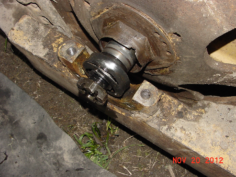

Sprocket nut and locking ring for HD6G. There are 2 hex sizes depending on axle spline.

Had the problem with the HD5B I had , the truck frame pivot inder back of tractor was worn and one bolt hole would not hold bolt tight allowing truck frame to move - Welded it up and ground area to hold pin tight - replaced axle and outboard bearing - ran machine couple years and no problems when sold .
 I do have a spare axle in my pile of spare parts yet I will sell .
2 splines were used a small spline and large spline - large more like what is used on clutch disc only larger and tapered.

thanks every one for the input. mr coke was the place where pivot pin hooks under dozer worn out where caps fit .this is my problem i was thinking of welding it up and grinding it out to make pin fit .just dont know how to aline the pin. dont know wonder if close is good .

the pin fits into saddle and lower cap on each end keeps it from moving - if you have a lot of slop there then might look at shimming the pin or replacing it as it sounds like your pin is worn also .
might drop the other side and see what clearance is there also -
with the 5A, 5B they used a equalizer spring so all the truck frame force is onto the bearing / axle and on those 2 mounting points on rear case .
 On the 5G and 5E they used a rigid cross member between truck frames and tractor frame - thus helped support the loader frame and oil tanks / lift towers for the loader .
 When I first got the machine and the truck frame was walking out on the one side I ran a cable across between truck frames to finish a job before i tore into machine .

the saddel and cap is worn .my friend put nw pin and bushing in truck but its  worn at the cap and saddle .i just dont want the owner to have any problems. i have rebuilt about 7 or 8 tractor engines for him just never worked on the dozer. he has 3 dozers . hes all AC .has  b.c ,wd,wd45, 190. 2.d19.d17, 7060.7080.wc. knot sure what else .and i rebuilt the engine in the hd6b. but thats enough hes a good man i just want to do it wright as i can.
