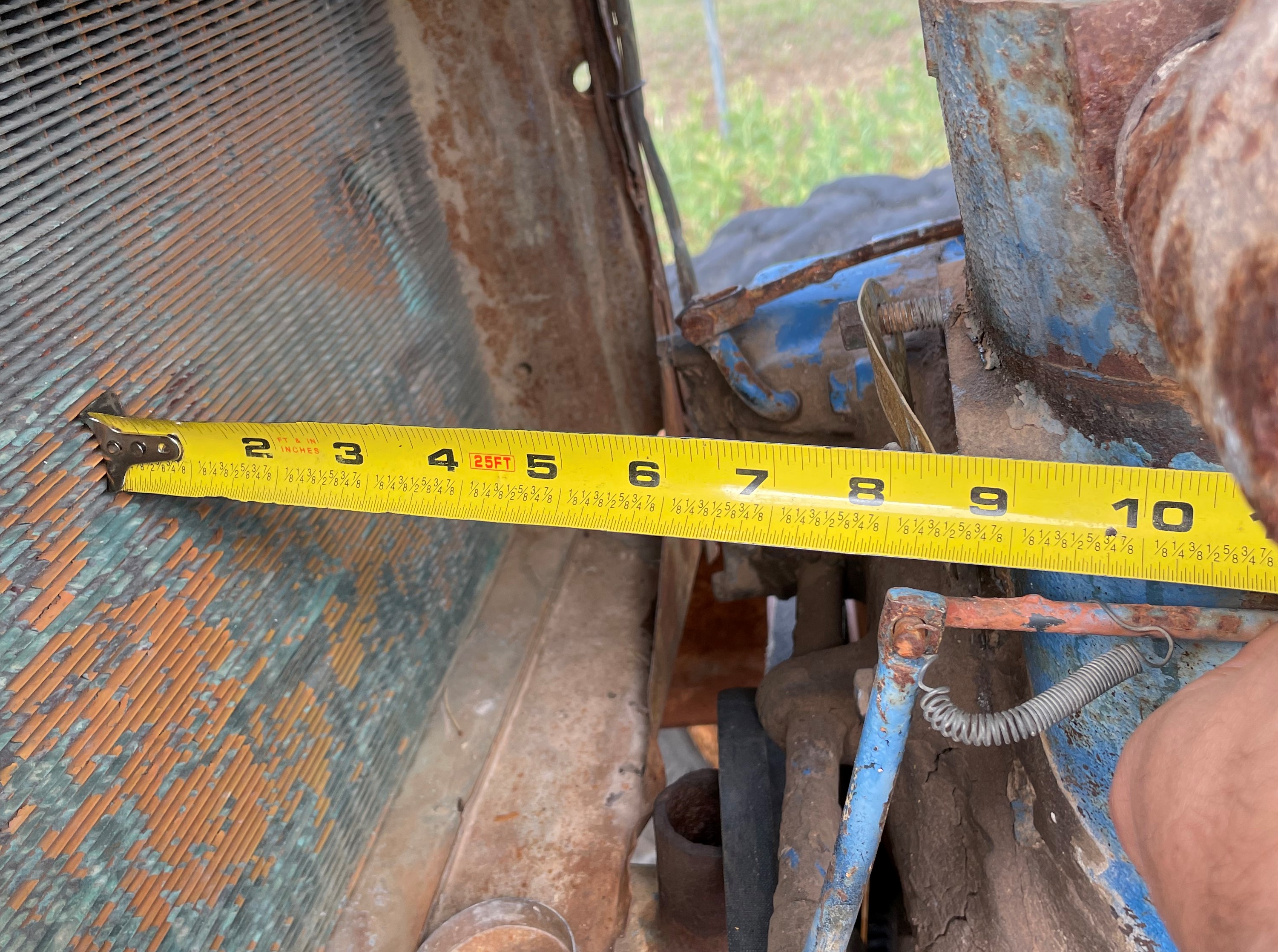

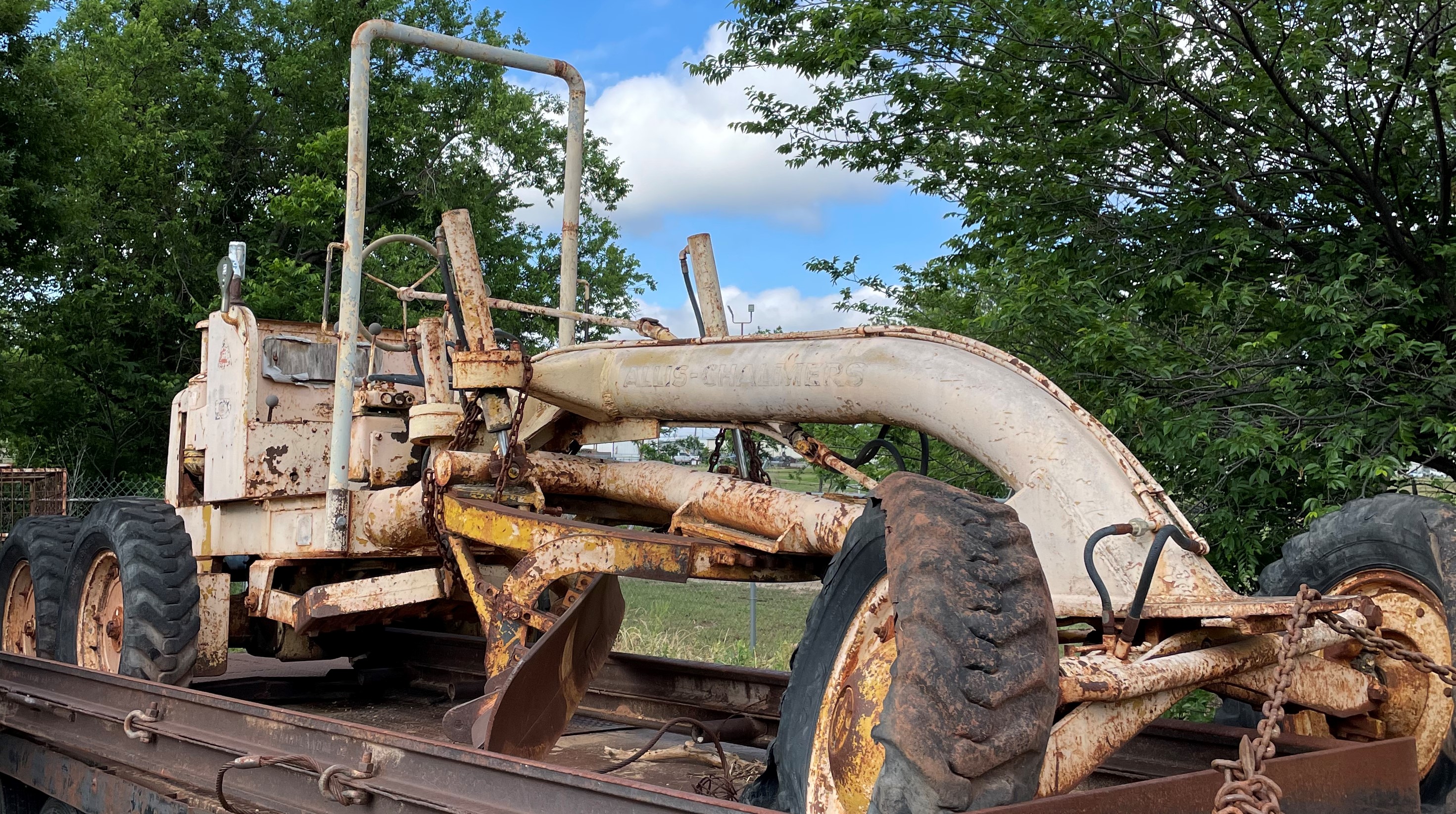

Old AC D Grader.  I'm needing a water pump that'll fit this machine.  Any help from y'all would be greatly appreciated.  I'd like to give this thing another chance at life.
  • Distance from bolt face of the water pump to the radiator is ~8.5"

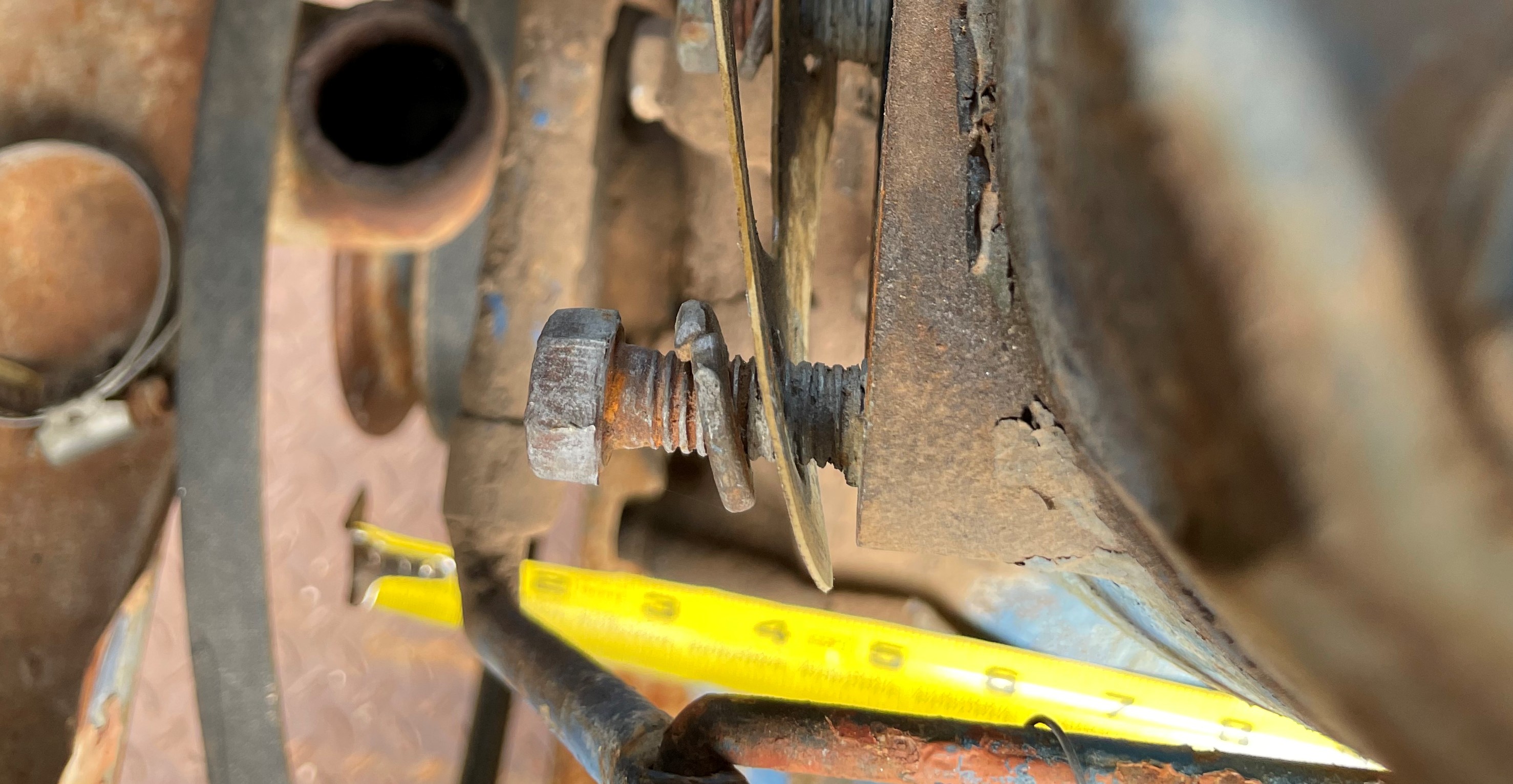

  • Distance from bolt face of the water pump to the belt groove is ~4.5"
  • Water pump is a three-bolt type

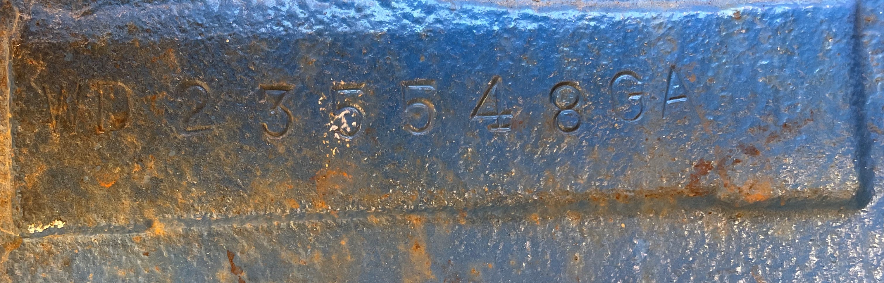

  • Stamp on engine is WD 235548GA

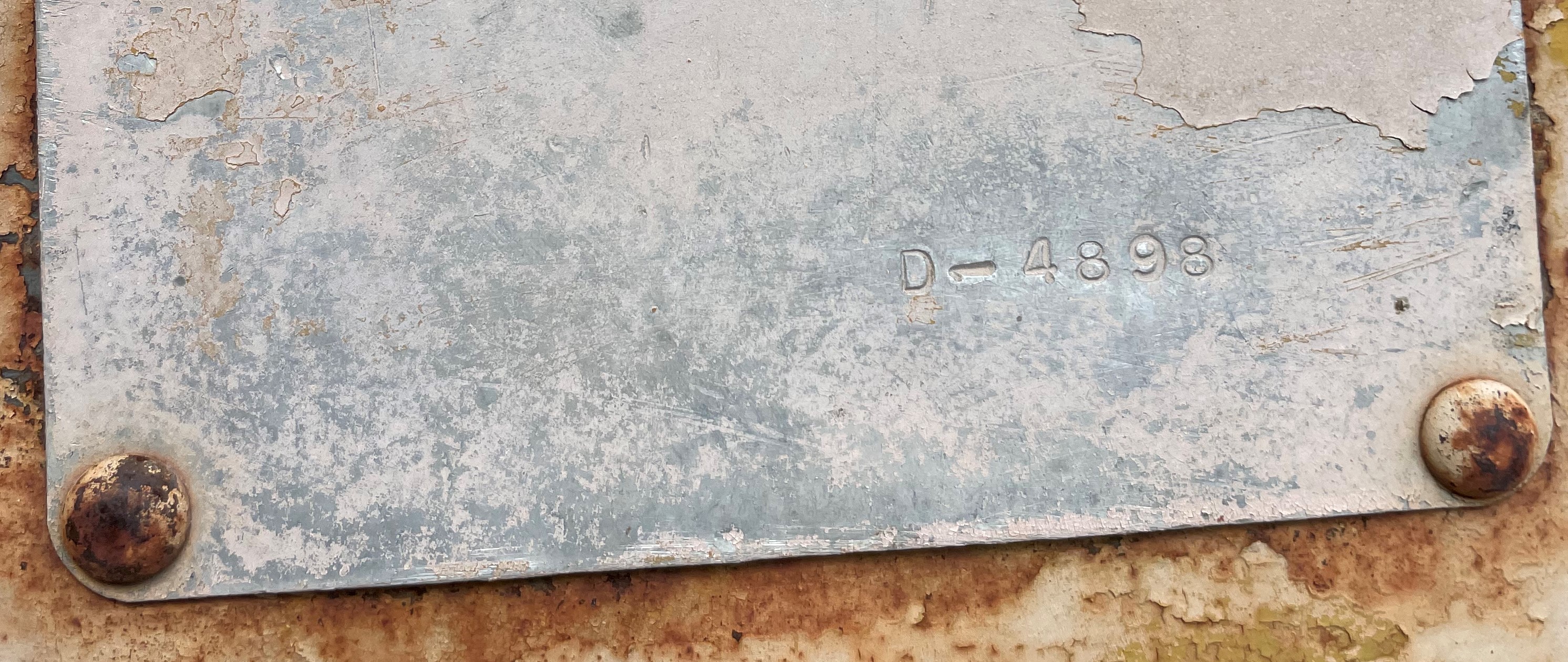

  • Tag on machine shows D-4898

It should have the very common G226 engine also used in one of AC's most popular farm tractors so a new water pump should be readily available.
Points: 8978
Post Options Post Options   Thanks (0) Thanks(0)   Quote SteveM C/IL Quote  Post ReplyReply Direct Link To This Post Posted: 11 May 2023 at 12:02am
Get a pump for a WD tractor.
