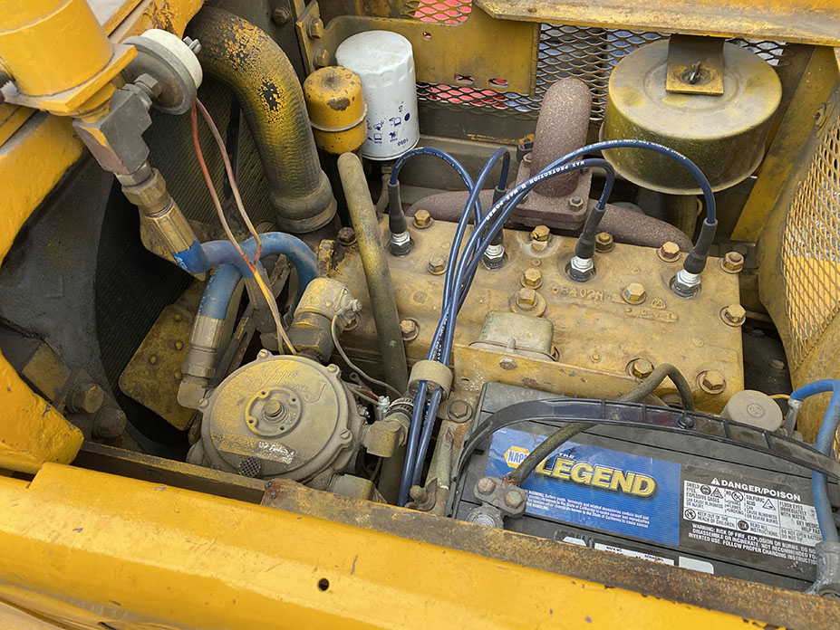

Hey guys,
I recently purchased an AC FPL 20-24 at auction and I wanted to get some help from the community.  Per my limited research, I believe that it has a Waukesha FC 4 cylinder flat head.  I was able to obtain the Waukesha service & parts manual from the Waukesha organization, they're a great group of people.
Furthermore, I would like to share my renovation of the AC lift with the group.  Everyone seems very helpful and eager to keep the AC name out & about.
Currently, the brakes do not work (pedal goes to the floor) and the engine does not stay running.  I've not worked on LP units before, but plenty of gasoline carbs, etc.    The engine starts right and the prior Gov't organization that maintained the forklift put in new plugs, wires, battery, changed the oil, etc.  The engine does not stay running and will stall out, I can move it, with depressing the clutch some, but it will stall out shortly.  I'm thinking I need to rebuild or clean the carburetor.  The forklift has always been kept inside, and has around 6,000 hours on it.
Can anyone tell me the year of manufacture, based on the AC plate?
Any other advice besides cleaning or rebuilding the carb?

When I got the forklift, it would run, but would hesitate and stall out, so I'm attacking the carb.
I was able to pull the carb off this week.  Per the original parts book by Waukesha, they reference a IMPCO Carb (51091-A).  Not sure if this is original to the forklift, can anyone verify?  I do plan on pulling the carb apart over the next week.
My other question is where is the best place to get a replacement carb or a rebuild kit.  My general google search has new versions for $140.
I'm excited to get this lift working!
OldSchool33 View Drop Down
Joined: 02 Mar 2021
Location: Maryland, US
Points: 8
Post Options Post Options   Thanks (0) Thanks(0)   Quote OldSchool33 Quote  Post ReplyReply Direct Link To This Post Posted: 08 Apr 2021 at 3:11pm
So, I took apart the IMPCO 100 carb, the diaphragm was covered in oil.  The outside of the carb was covered in oil as well.  In fact, some of the bolts on the carb were not very tight, so I'm guessing oil got into the carb since it sits on the side of the block, below the exhaust manifold?  I'm cleaning everything up now and installing new gaskets and a diaphragm.
The original issue was the forklift kept stalling and would only run with the choke, completely out.  I'm not sure how the excessive oil would impact the performance of the carb?
I haven't taken apart the vaporizer, should do this as well?

Post Options Post Options   Thanks (0) Thanks(0)   Quote DiyDave Quote  Post ReplyReply Direct Link To This Post Posted: 08 Apr 2021 at 5:39pm
Check the bushings and or felt seals on the choke shaft.  if it pulls air in through worn seals, that will cause the problem you describe...Wink

Post Options Post Options   Thanks (0) Thanks(0)   Quote OldSchool33 Quote  Post ReplyReply Direct Link To This Post Posted: 05 Dec 2022 at 7:02pm
I wanted to close out this post.  I was able get the engine running!
'DiyDave' hit the nail on the head.
There was a vacuum leak in the carb assembly.  After resealing and making some gaskets, the forklift runs amazingly.
