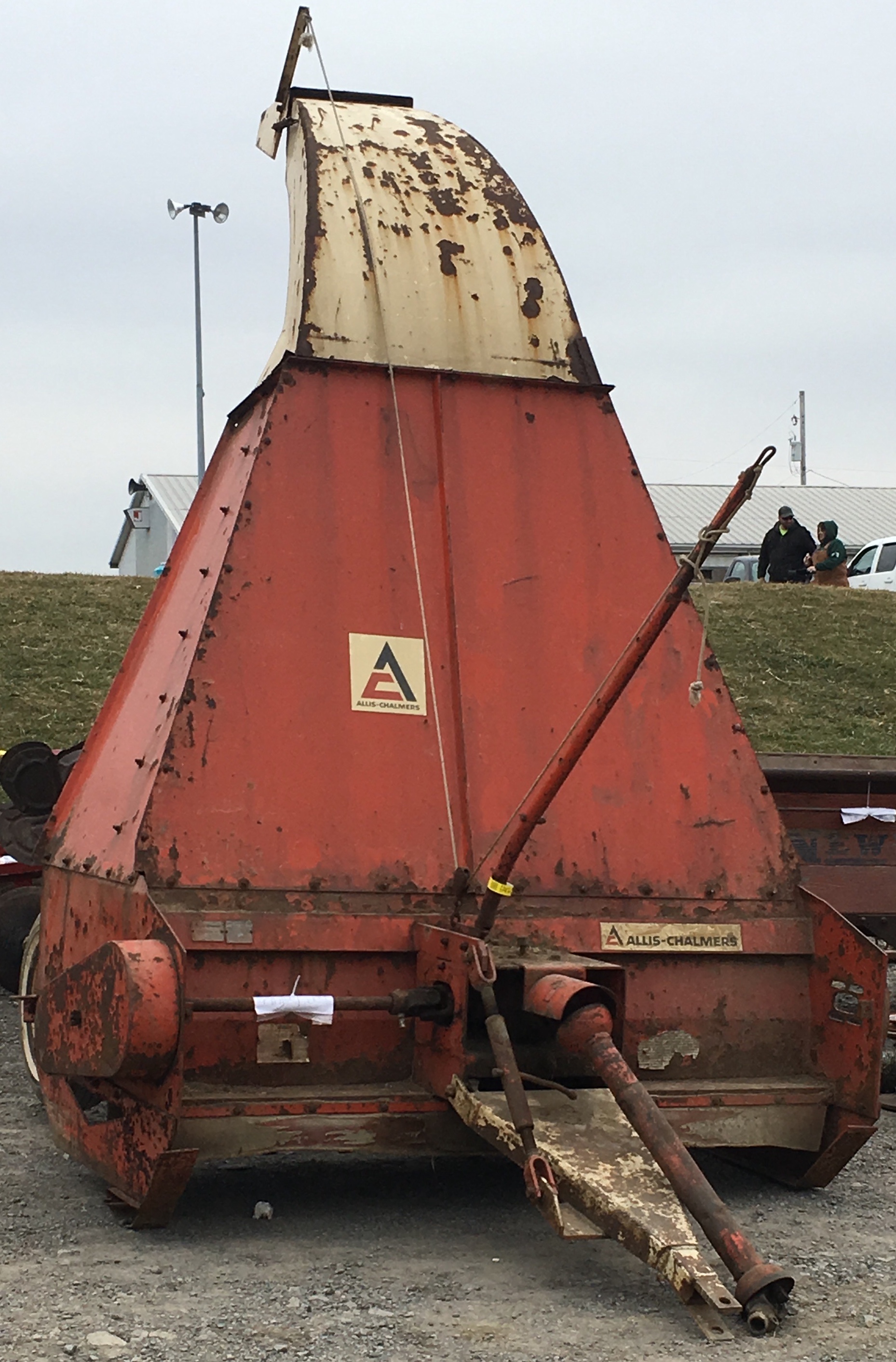

Anyone have any information, regarding the Oppel Harvester Co. and it’s relationship with AC? Picked up this AC flail chopper this weekend, and would like some more insight; model 80 or 800, years produced, etc.? I looked through Swinford’s book as well as Wendel’s, and can’t seem to find any information on them. Serial # C50062. Thanks!

Yeah, it was at Kidron. I plan on restoring it to use on our farm. Only thing that is missing is the left side PTO shield. I’ll probably just fab one up for it if I can’t find a replacement.

AC had a partnership with Oppel a few years where they marketed flail shredders, potato harvesters, beat defoliators and beet harvesters.
I have seen a number of these shredders around and know of two that are still in good condition.
I think when the partnership on the potato harvesters ended so did everything else with Oppel.  I do not believe they are in business anymore either.

Oppel Harvester was located in Boise, Idaho. They made equipment for
several different equipment companies such as AC, Farmhand, and Gehl.
Some of Heston's equipment may have came from there its been so long I
Can't remember. Oppel is long gone and site has been flatten and even
the railroad is gone and is part of Boise's green belt. The highway is
now a county road.
Bryan l.

Thanks for all the great information so far! Any idea as to what years these would’ve been produced? I’m assuming these preceded the 56f flail harvesters?
