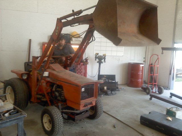

After my mechanic worked on the AC 720 for about 8 weeks, we finally got it running and almost lifting an ARK 600 front-end loader, until another dry-rotted hyd. pipe ruptured! Among other things, we had replaced the starter-switch, rebuilt the starter, but couldn't get starter to even try turning. Finally wired in a relay switch to give continuous 12v to starter, and it worked!

Good to see you got it together Bruce.
Seems like I saw the loader before.
