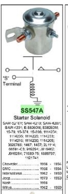

Here is a Standard Motor Products 12 solenoid relay used on some GMs. 300 amp, non- continuous rating.
HTH
Points: 8367
Post Options Post Options   Thanks (0) Thanks(0)   Quote DougG Quote  Post ReplyReply Direct Link To This Post Posted: 24 Mar 2019 at 2:57pm
Thank you Jim ! Just what I was looking for!

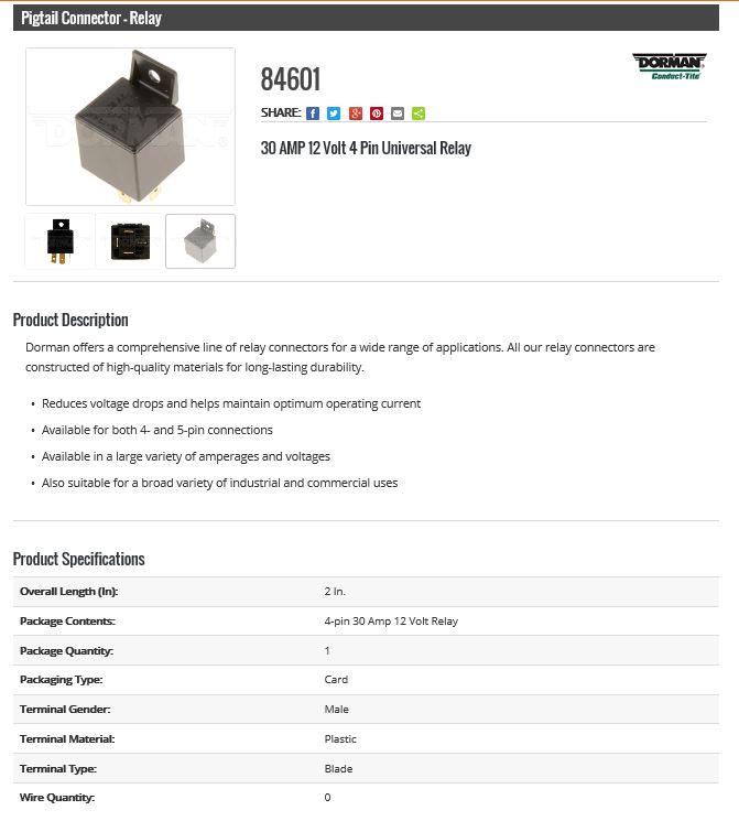

Post Options Post Options   Thanks (0) Thanks(0)   Quote DougG Quote  Post ReplyReply Direct Link To This Post Posted: 25 Mar 2019 at 6:27pm
Thanks for the info guys,, any pics of the wiring done to make this work or explain which color goes where on this Dorman relay, thanks again
Edited by DougG - 25 Mar 2019 at 6:28pm

Post Options Post Options   Thanks (0) Thanks(0)   Quote Jim.ME Quote  Post ReplyReply Direct Link To This Post Posted: 25 Mar 2019 at 6:55pm
The terminals on those are numbered and most have a diagram made right on the plastic shell. You can do a search for that Dorman number and find a number of images on line. Several manufacturers make these and they plug into boards in vehicles, so the terminals are standard. I would post one for you, but can't on this device. Likely an operator issue, not the device.

30 amp is not big enough. Will work but will not last.    MACK

You would want to use a regular high amp solenoid like the one in Jim's pic. Standard Motor Products or Cole Hersee are top quality pieces. I carry both in stock and use them on my 12V conversion Starter motors. A Ford style would work fine also. That code 1 relay is way to light for that type of application. Won't take the continuous duty needed to crank over the engine. Our 1501-08E solenoid would fit the bill there. Even has an override button on top to the solenoid for bumping the engine over...

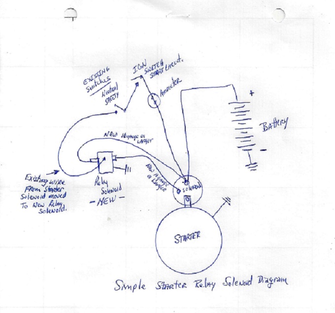

Currently my 6080 has occasional no starts, but in my case there is zero starter spin.  I wired a test bulb on the starter solenoid and found no light at all when twisting the key.  So, I figure one of my safety switches is making intermittent contact because when it does crank the test bulb lights right up.  At first I did suspect a low voltage issue because hooking up the battery charger to the batteries would make it spin, but the light told me it was getting zero volts with out the charger.  Apparently the boosted voltage from the charger is forcing the faulty connection in the safety switch to make contact.
That being said I know I did have a low voltage issue before I put new batteries and cables in.  If it should come back again I would like to know more abut this added solenoid.  I am having a tough time trying to draw a mental wiring diagram to see how this is being added on top of the existing starter solenoid.  It's also been two years since I looked at the manual's wiring chart so I forget how power is currently routed from the key, through all the safety switches to the solenoid on board the starter.  Is the additional solenoid completely by-passing all the safety switches and going straight from the key to the new solenoid?

Post Options Post Options   Thanks (0) Thanks(0)   Quote exSW Quote  Post ReplyReply Direct Link To This Post Posted: 01 Apr 2019 at 12:44pm
You're overthinking it. Do a little research on how a relay works. The relay transfers main starting power from the battery through itself to the draw(starter).This is why you have to use a heavy duty relay. It carrys all the current. The wire that excites the starter at the starter itself will be the wire that trips the relay. Find a 70's Ford or Dodge pickup that has the relay/solenoid mounted on the inner fender near the battery. Look at how it's configured.

Post Options Post Options   Thanks (0) Thanks(0)   Quote Jim.ME Quote  Post ReplyReply Direct Link To This Post Posted: 01 Apr 2019 at 3:58pm
Michael (WI),
Here is a simple sketch for you to look at. All the existing starting circuit wiring remains, with all the safeties. You need to be sure those are all working properly, adding a relay solenoid won't repair a bad component.
