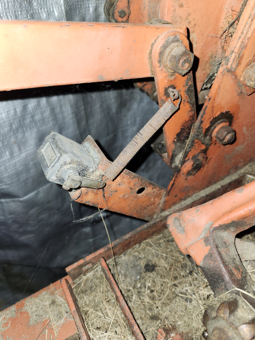

The bale counter was missing the spring when I bought the baler. I just got the spring from AGCO for $1.89 but don't know exactly where to connect it. There is a cotter pin head forward of the counter  that looks like it was intended for the spring to connect to, but if I attach it there, the spring seems over stretched and puts a LOT of pull on the poor little counter. Anyone have a photo of this set-up they would share? I looked through the various Manuals but didn't see anything helpful. Thanks.

Post Options Post Options   Thanks (0) Thanks(0)   Quote plummerscarin Quote  Post ReplyReply Direct Link To This Post Posted: 19 Jun 2025 at 10:10pm
Here you go
This one is attached to the cotter pin
Shazam!

Well this photo explains a lot. My bracket is bolted to the side in the center of the U- channel cross member 4-5" back further than yours, and the counter is turned 180 degrees with reset knob towards the inside. Thanks for making the effort to help, appreciate it.

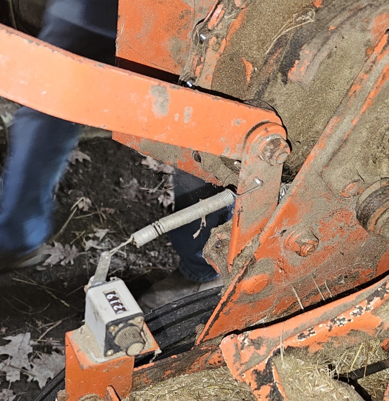

Post Options Post Options   Thanks (0) Thanks(0)   Quote Driverdan Quote  Post ReplyReply Direct Link To This Post Posted: 28 Jun 2025 at 9:06am
Here's a picture of my counter.  I made the bracket out of 16 gauge flat stock.  I hope this helps.
-Dan
Allis 303 with Couner

Thanks for the photo Dan. Apparently your set-up and bracket work for you, which is what matters. From the photo plummerscarin posted, I was able to relocate my bracket to the correct location and everything now fits properly. Thank you for your efforts.
